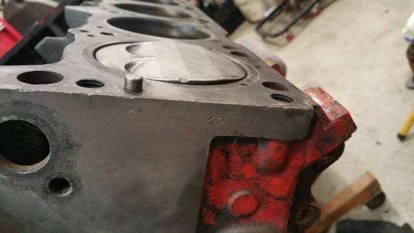

Do domed KYB 399’s interfere with 302 cast heads?
I would imagine, If the OP is willing massage the Dome's a little if needed should be able to make them fit.
I s
Use the search function and see who has used 399’s. The dome style may need to be shaved for clearance of the closed section of the 302 chamber. The 340/360 open chamber will clear just fine unless they’ve been milled down to nothing.
I Searched and I couldn’t find the info I needed from anyone using these heads with the combo. The domed pistons are almost the same shape as the stock 273 high output domed pistons which were used with the same heads im looking at. However they are t stock and non stock pistons tend to come closer to the deck at their lowest point than stock replacements. I really think they’ll work, and worst I’d have to grind down the part of the quench pad between the valves. But yea sadly no undo that helps me :/ I know the lowest point of the heads and highest point of the piston but it’s sorta the area right in the middle. I wish I had a model of each part incCAD I could look at, I tried to find a downloadable small block mopar blueprint for cad but could t find one for the entire engine
But the optional factory domed pistons have nearly the same dimensions and ran with the heads im using, I know the highest point the piston will be above deck and lowest points on the head and how far the valve lift in planning on having is going to go, honestly all signs point to them fitting and giving me a static 10.82 to 1 compression ration with all otherwise stock parts which is what I’m doing, heads will be ported and will have a cam but valve clearance I know isn’t a problem. I’ll grind down a small about of the quench pad if needed but I think they should fit so I figured I’d come here and find out if anyone has, search feature was fruitless on this one but similar comes work in the 273, same head I’m using and everything just a smaller bore; the high point on the piston is the same it’s just is the slope on the new pistons too steep and will that cause contact. I know what measurements I’d like with flat tops, I’ve done dozens of 318s decks with kb67’s at 0 deck with 302 or 920 heads and with the right supporting parts they have no trouble making 450-509 crank, I think with the added compression and the right cam choice I can get maybe 550 crank just with different pistons than usual. The dynamic compression with the cams I’ve been looking at will be about 10.7 to 1 almost exactly which would be perfect for me. Not too wild, can run on premium pump gas no problem but will still get up and go without hesitation. I’ve made 318’s with more compression with aftermarket parts and they were awesome, up to 13 to 1 compression as long as you have a quench pad with a small enough gap running premium doesn’t cause knock at all
I don't think there's a ghost of a chance in hades that that dome will clear the head, even on the spark plug side. That's what they're made for. To mill for quench. A 2 minute phone call will solve the question.
I agree the wises move is to call.
From what I got from the thread I got the pic from 72DMag says he measure and found clearance but like you said I'd still call to make sure.
It's one of those instances where you want to be 100% SURE. Even if UEM says it will clear, that's not enough for me. I have to measure. It's not worth the consequences if somehow someone is incorrect, OR if your combination is somehow "off the map".
There were no optional factory domed pistons for the 318. Not in this country anyway. The closest comparison would be the 273 Commando and those domes are entirely different.
Tbh I think my only possible point of contact is actually the center of the quench pad on the head; I’d rather grind that down a bit. I’ve said it here a bunch now but the 273, same stroke smaller bore; same rods and crank; and the same heads that I’m using essentially (they had 920 castings which are closed chambered with smaller calves than the 302) had optional dined pistons almost the same in shape and tan fine from factory. So I honestly think they should fit and I’m willing to buy them and try anyway because I have normal 318 heads and I can deck those a bit if need be. Using factory adjustable rockers from a 283 because oh my god rockers are expensive

Im talking about the 273, and they’re a perfect comparison considering I’m using 920 heads from a 273, a cast crank from a 273 and the rods that were with it because they’re interchangeable. And I have commando pistons on the shelf next to me; where the dome is at its highest is the same as the commando pistons, I’m wondering if they are going to hit the quench pad between the valves. I’ve used 399’s no issue on stock 318 heads (I mean the 920’s were stock for 2 years so were cast cranks) thatre open chamber so 68+ and they don’t even make a ton of compression so I think they would fit. I know how far out of the hole the cylinder goes and the lowest area other than the quench pad in the head. Plugs definitely would clear I don’t question that from experience building these in all sorts of other ways and knowing was will fly. But yea might get them anyway because I have plenty of heads I can use I have some X heads that are open chamber but the valves are bigger than I’d like. Even the 302 has bigger valves than I’d like which is why I want the 920s. I know I can get more power even with the slightly smaller valves from experience
Here's the 273 Commando.
Now here's the 318 dome you plan to use. Not even close to the same. All we're doing is trying to be the voice of reason and advise you to be SURE, instead of doing something "just because you read it on the internet".
They are FAR from the same. If you already have your mind made up, then go for it.
I get what you’re saying, I have other heads I can use that I’ve used 399’s with before I have 302’s and was to see if they’ll fit or what material would have to go to make them fit as the measurement of how far they stick out of the block it fine. It’s the center of the quench pad that I’m worried about. But I’m curious. My main questions was if they interfered, just in case anyone knew from experience. I can make pistons at work we do all the time but asymmetrical domes aren’t easy to make and making all 8 for my own car so not getting paid would be rough. Also I need to go look at part numbers as the 399’s aren’t the only pop ups I saw just the only ones from a brand I’ve used successfully literally hundreds of times now.
Also when I say they’re a perfect comparison it’s because at a side profile you can see that where the slope starts and goes up looks like it should be gradual enough to clear the quench pad. I know they are different designs completely but the profile shape towards the center where the concern is is close between the two and helps me get a bit of a guess. I have my mind made up on the pistons; I already have multiple sets of heads and I wanted to know mainly so I could get started refinishing the heads but I’m just going to wait until I have the pistons then I can just check. I’ve used these with 340 J heads before and they are fine and I have like 4 sets of those so I’ll use em if I have to. Just trying to get 10.5 ish dynamic compression and these plus the 302’s would help me get almost exactly there with the right cam choice. Not deciding on cam until I’ve decided on almost everything else
Once more. They are FAR from the same. The dome is but one part of the picture. The KB pistons have a larger dome and they have a taller compression height. No one is trying to talk you out of using your pistons, chief. Nobody. We're saying you need to measure. Mock up and measure. Good luck.
I am a professional engine builder I port heads for a living and have build literally hundreds of engines for work and dozens of mopar small block and I’m a mopar guy, the 920 heads on the 318 flow more air than 302s into the cylinders, the larger valves are too shrouded, we end up getting more air through our 318’s with 920’s than 302’s that goes for stock and with bolt ons like headers, street cam, intake and carb. If you’re aiming for over 5-600hp then you’ll want larger valves for forced induction but 450 crank is a very easy number to crack out of a 318. We build a ton of them for all the people buying 318 cars because big block cars are so expensive, 340 cars even. The 302’s are superior on the 340 because that shrouding isn’t bad. But for a street engine with a mild cam, 600-750cfm intake with whatever carb combo you’d like and headers when I port 920s and 302s the same just basic porting even not me referencing my cutaway head shelf to see what material I can remove they have a higher port velocity and his high enough that we measure more air coming through them than any other head made by Chrysler that fits a 318. Unless you go notching the cylinder walls for no shrouding. I’m saying this from experience at work and the fact it’s my job. I came here just to see if anyone had tried running that combo before but I guess I’ll be the first to try and I’ll post about it, I’ve got almost every small block head Chrysler has made lying in storage here so if the closed chambers are a no go then I’ll let y’all know what the smallest chamber I was able to use was. Doing a very budget build with a 450 crank hp minimum and a goal of 500 with only pistons, intake, carb, cam and I make headers for the engines I build at work so I’ll probably make those if I have time if not cheapo pair until I can make nice ones. Budget for the engine is $1500 it shouldn’t be hard at all tbh these things are so overlooked. Budget counts for alternator and pulleys/brackets, like it needs to be ready to drop in the car. I’ve actually done it before but I want to make more power, last one I did this way made 418 at the crank with a $1000 budget.
Says who ? The problem when you look at only one or two factors and ignore the rest.
Could a 273/318 be ported out to make 450-500 hp possibly but very very unlikely especially if not done by a great head porter.
340 bore definitely better but 318 bore is still a fairly large bore especially with an overbore.
1.78 valves and heads were designed with 273 bore and displacement in mind, not a 318. A 318 bore is .285" bigger than a 273 bore basically a similar difference between a 318 and a 413 bore, a 318 is a lot closer to a 360/340 bore size then either a 273/413 especially after a 0.030-0.060" bore job. 4.8/5.3l LS only haves a 3.78" which would make 318 be bigger by a 0.130" which is same difference between 318 and 340.
I understand that, I have their models both downloaded in cad to compare and again the only area of concern with how high they’re coming out of the hole is the slope up the dome. Just want to try and run domes, I’ve run these pistons on plenty of small blocks, they always sit at least 10 thou in the hole at their lowest point, like a flattop 167 sits about 10 thou down still if not more, stocks usually like 40 thou or more and the piston will fit the height inside the 302 heads, I have measured that. However I cannot find a downloadable 3D design of the engin and head so that one little spot I just have no way to measure and be sure about without asking someone or trying. From what I can get from the cad scan lined up at the wrist pins with the other the slope on the 399s starts way later than on the commandos. I have a real commando piston next to me but that doesn’t help much besides knowing this clears just fine and trying to get a measurement of how much space between the piston at TDC and center of the quench pad with 399s. I understand what everyone is trying to do, I know they may not fit and have heads picked out of my stash for that case already I just want to try so I figured I’d ask if anyone has done it before. I’m totally aware they may not at all work with the closed chamber heads, if that’s the case I have a plan to deck some open chamber heads a bit at work and go from there. I’d like to see 10.5 to one dynamic compression out of it and with the 302/920 heads, and the 399’s I could be there so I just am curious.
