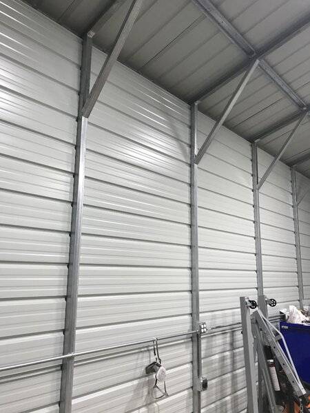

so it would be better for me to install the panels over the existing metal framing, then fasten the insulation panels to the framing, rather than installing insulation panels between the framing?
My building is 720sqft, would two small box fans from the local home improvement store be enough? I would like A/C but anything greater than a window unit would be unlikely.
Yes , as long they are on 24/7 . THat will stabilize the moisture content allowing you to control the humidity
Yes. Between can work, but it will have multiple drawbacks. Heat will be conducted in/out by the metal framing, but worse it will allow condensation to form at the edges of some of your insulating panels. This can draw bugs and mold etc.
One sealed envelope will help seal the wind out and will also be a neater install in my opinion.

Darn, what sucks is I already have my electrical installed over my framing.

Ok guys, after some additional research I think I have a plan for what I am going to do. I think I am going to use 1 inch polyiso foam boards (foil on both sides). And place them between the beams, while foil taping the exposed metal on the beams to prevent condensation (does that sound right?).
Once the foam boards are up, I plan on using a thick plastic vapor barrier to cover the foam board insulation. I’ll be insulating the walls first, and then the roof. Once the building is fully insulated, I plan on installing a wood burning heater along the back wall (the wall across from the large doors) towards the center of the wall so it can heat the shop evenly.
IMO this should be a relatively simple, cost effective way of insulating my shop.
what do you guys think?

if I cut the boards to fit between the uprights on the walls I think I can wedge them between the framing. The tubing for the framework on the walls is 2inch. If I install the boards flush with the tubing on the inside of the structure, that should leave me 1inch of airspace behind the boards

You'll want a layer of foam over each exposed metal member, otherwise those cold beams will still sweat inside.
The idea of leaving a gap and securing directly to your framing is a good one, but the air space will act more like a "rain screen" and won't necessarily make the wall better insulated.
Since you have surface mounted electrical, I'd stick to your plan of going between beams (and overlapping a second layer over each beam). Later on you can add another layer and a few years later another layer... Etc.
Don't bother with the interior vapor barrier. The foil facing of the foam will act as one already (usually) and having the ability to diffuse any random moisture is still a good thing. Some sort of durable wall board would be a good idea to protect the foam boards. Plywood, osb, hardboard, drywall, concrete board, doesn't matter a ton, but any all-wood materials are at greater risk for fire than drywall (which actually produces moisture/water as it gets heated) or concrete board.

I didn’t even think about putting small pieces of foam over the framing... duh haha
what do you mean by rain shield?
I like the idea of covering the insulation with something but I’m worried about the additional weight it would impose on the structure

Rain shield or rain screen is a term used to describe an exterior cladding that has an air space behind it. In contemporary construction it's done to prevent trapping rain or condensation between the cladding and the exterior sheathing or wind barrier. It can act as a radiant barrier space and also a thermal gap to prevent conduction from the framing to the exterior. The draw back is that it gives bugs a great hiding place and makes a wall assembly thicker for not a lot of gain in true insulation performance.
The weight of any interior wallboard is good to keep in mind. A sill plate could be bolted to the foundation and used to support the weight of the wall off the framing. Use good pressure treated lumber and it should last plenty long enough. As long as you're not framing a lumber wall to hold the interior sheathing, the slab should be sufficient to hold up the dead load it may impart. Metal siding would likely be the lightest per square foot and drywall (1/2 or thicker) the heaviest. You can look at lightweight drywall too, which is easier to handle if nothing else.
