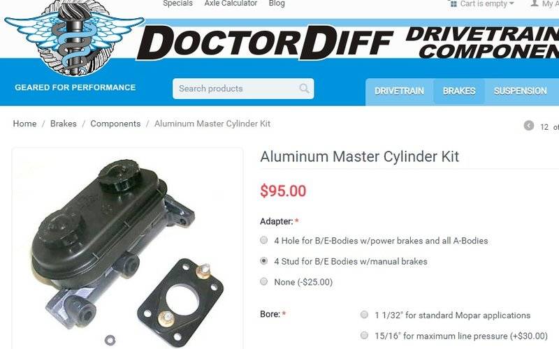

... I know there was at least one post in the last few months showing the kit (MC + adapter plate) from Dr Diff ...
If somebody did search, please post the link for everybody.
For example, I typed "Dr Diff" w/ "Master Cylinder" in Google and easily came up with this FABO thread
www.forabodiesonly.com/mopar/threads/dr-diff-master-cylinder.348853/
with link to
www.doctordiff.com/aluminum-master-cylinder-kit.html
Finally, a screenshot from Dr Diff's page. Pick 15/16"D or 1-1/32"D (if feeling manly).
