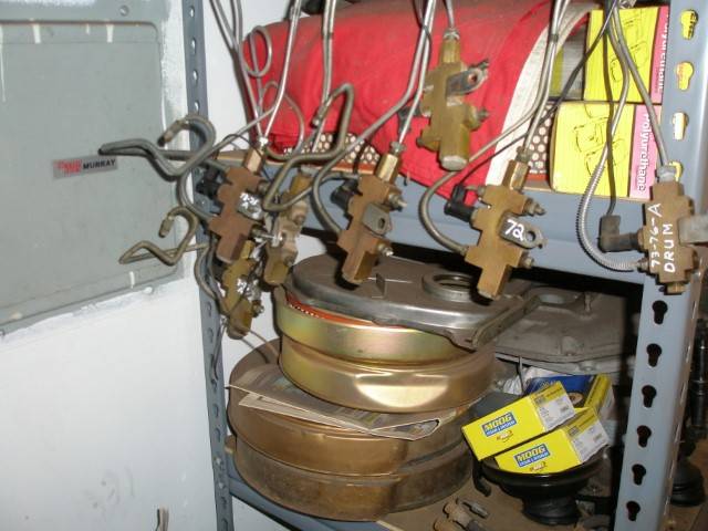

Can anyone point me in the right direction for a K/H proportioning valve re-build kit, or a new one. I have the original set-up on my 1971 Demon.

Can you post a picture of the one you have? I've rebuilt one that I bought off the forum with no issues. I used the kit from Muscle Car research, he sells different kits.

See post #8.
He already replied, that he has the one pictured in my reply.
Yup......A Weatherhead unit. Bought a couple of kits. Thanks for everyone's input. Hopefully my core is serviceable, or else I'll be looking for one of those here lol. I am planning on running silicone brake fluid since my build is totally dry.
Ok got it, the OP wasn't asking about the adjustable valve, just his OEM distribution block/valve assy. I guess mvh's mustang reference steered me off course.
Anyway my sources do claim mustangs and others were equipped with the valve shown in the pic you posted. It is adjustable and was placed in the line leading to the rear brakes. I'm not sure its visible when looking under the hood.

No such thing as an "adjustable" proportioning valve on any of the A body line of cars, so i haven't got a clue what your talking about.
If you do have a 71, and then the "factory" valve will be this one.
And this valve was used from 70-76 on the A body line of cars.
And i had lots of them in the past, that i used to put up for sale, on this site.
So i think i know about these valves.

Got my kit and it went together awesome. Great online support from Muscle Car Research. I had trouble getting the small piston out, but I rigged up a couple of fittings for my grease gun and hydraulically pushed it out. Took a while to clean it out spic and span but all in all it worked out good. Thanks.
