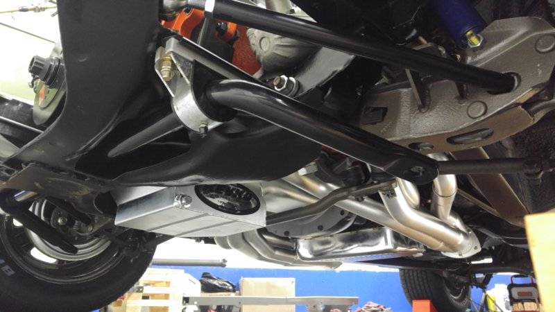

I'm running the M302 5qt / 6qt pan. Fits just fine, clears everything.
The one the original poster listed has a kick out. I run the 302 for 360. The only thing I dont like is the drain is outside the baffle arear so it never or takes forever to really drain. I just welded another plug on the rear corner which solves the issue.
Yeah, trying to figure out if the extra 1-3/4" on each side is going to require some major cutting or not. Looks like the 7 qt Milodon requires trimming and the Milodon road race pan requires windage tray, needs clearancing, and cost the most.
