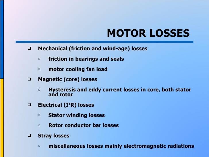

I'll leave off the pictures. I get it. There are more losses involved with an electric motor. You can leave off the equations and just quote the 2nd law of thermodynamics. Rather than using mechanical energy directly, you're converting mechanical energy into electric energy and back into mechanical energy. That has to involve more loss than just using the original mechanical energy. There's a percentage loss from both the alternator and the electric fan motor, no way around it.
But, that's not the whole story. For that comparison to work, you'd have to be spinning the same fan blade in both cases. You'd also have to be spinning it the same amount of time, and at the same RPM. None of those things are true. The fan blades are different, they're spinning at different and variable RPM's, and they're spinning a different amount of time. Electric fan blades usually spin at one or 2 different ,constant, speeds. If designed properly, they will spin at either the most efficient speed, or the speed that results in the most cfm, or maybe both if it's a 2 speed. Mechanical fan blades spin over a wide range of speeds, and just like looking at horsepower on a dyno curve there's a peak efficiency that will come at a certain rpm and a peak cfm flow that will occur at another rpm. If you're spinning your mechanical fan at 2,000 rpm and the peak efficiency is at 3,000, you're losing efficiency. And of course, any time the mechanical fan is spinning that the electric fan isn't is 100% loss. If you use a good fan controller the electric fans will be controlled more accurately than with a fluid coupler, and so, less loss from spinning the fan when it doesn't need to be. And they there's other considerations, like the weight of the mechanical fan (usually metal) compared to the electric fan blades (almost always plastic). And if you're running a fluid coupler, the weight of spinning the coupler as well. The heavier the rotating mass, the more energy it takes to spin. And then, there's the accuracy of the fan controller again. A programmable electric fan controller can keep the engine in a very small operational temp range. Like, 10* small. If the engine is always operating at it's most efficient temperature, the engine will be more efficient. And a few percentage points of efficiency from the entire engine is worth a lot more than the percentage loss between the different fans.
