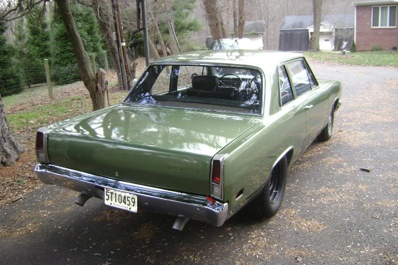

Here's ours. We ad a completed build thread over at bigblockdart but it looks like it got lost in the upgrade.

The color on the valiant is F5 lime light green metallic.It was a PPG brad paint, their Omni line of paint. You can get it in either single stage or base coat clear coat.
