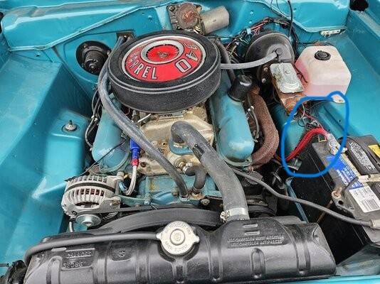

If you look at a members '69 Formula S posted on another thread, you'll see what appears to be a rare factory p/s cooler mounted above the reservoir.
Like I said, just my experience.
If it doesn't spill for you, great- but something to be aware of if you do run into issues.
