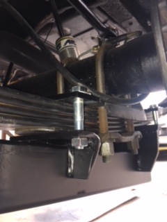

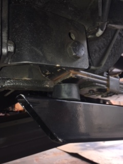

After about 40+ years of trying to find the best solution for ride quality, traction and handling, I ended up with slapper bars with a cut front bump-stop that are properly fitted to place the bumper under the front spring eye.
The correct length Lakewood bars with cut, welded and fitted stand-offs to just clear the rearend brackets and upgraded hardware work better than Caltracs, pinion snubbers and/or nothing.
Total cost is about $100 and a few hours of fitting. Combined with Drag radials and QA1's, I've never found anything better on the street that gives both decent ride quality and amazing traction.
I use this set-up successfully on both my stick shift E-Body and automatic A-Body. I'm using ESPO +2's on the E-Body and 3200lbs driver's side SS springs on the A-Body. Both cars are close to 3750lbs.

I bet that works good!
