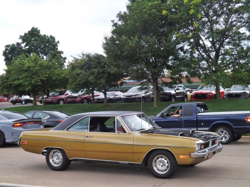

I realize it's not a Duster, but the previous, previous owner of my '71 Dart GT installed ManciniRacing 2800lb springs. I've had the car since August 18, 2003.

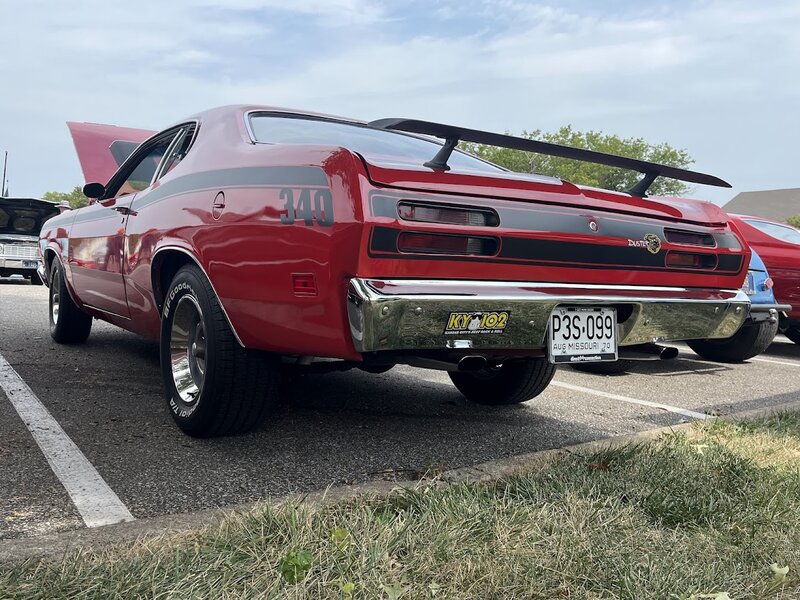

I have ESPO on mine. They were ordered as 340 replacement springs. Once I swapped in 6 speed I had to clamp the front sections to get rid of wheel hop. Overall they are great springs.
another vote for ESPO - I have them on all three of my 1970 Darts, some are as old as 20 years. Be sure to specify the 6 leaf springs that are like the factory springs for 340 cars and specify the front spring bolt size (I think your later A-body came with the larger bolts). I like mine with the +1 arc

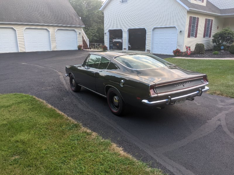

Adding my 2 cents for ESPO, went with +1 on my Barracuda, only thing I’d add is consider buying adjustable front spring hangers from Mancini or Uncle Brian’s. I’m glad I did, the car sat just too high for me when I put the new springs on, but lifting them by one hole on the hangers (there’s 3 in total) sat it just right.
Remember the springs will settle a bit over time (probably depending on how much you drive it) I hadn't though about it but another argument for adjustable front hangers.
