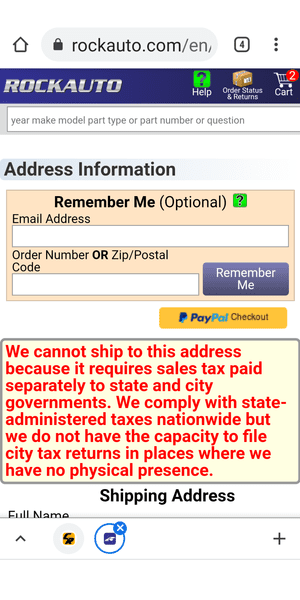

It has something to do with each city / county / and the state of CO can have their own tax and RA would not deal with that many variables in the tax being charged.

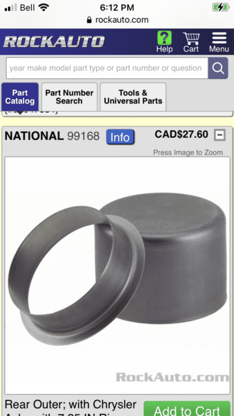

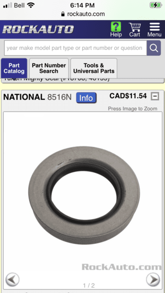

Looks like 7.25.9 bolts. different brands,same seal. I included the repair sleeve,you wont know if you need it until you pull yoke. Yoke puller is my harmonic balancer puller,bolted to yoke with two bolts diagonally.
Looks like 7.25.9 bolts. different brands,same seal. I included the repair sleeve,you wont know if you need it until you pull yoke. Yoke puller is my harmonic balancer puller,bolted to yoke with two bolts diagonally.View attachment 1715690682 View attachment 1715690683 View attachment 1715690684
Thanks Tooljunkie for the references, the parts have been ordered which totaled $30.56$ I sourced everything from Ebay using the part #s. I went and got the sleeve too might as well since I saved$. I will tackle this likely next week. This community is great and have been super helpful Moparmat always chimes in and gives good tips. I am appreciative!
