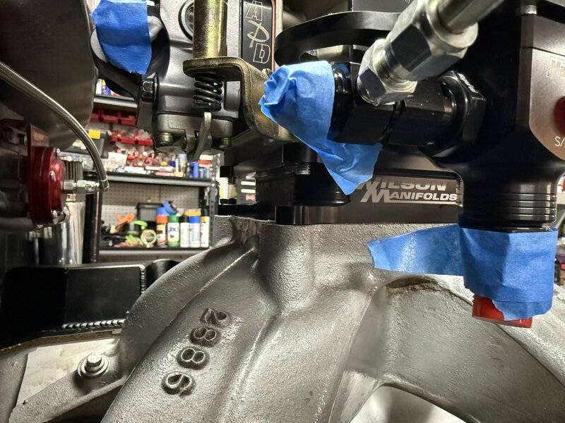

I am switching over to alcohol for this season and a lot of the reason and recommendations came from reading posts by PBR on here (I had APD convert my carb to alcohol for example.) I read several posts by him recommending running a lean-out valve to get heat in the engine. I think I understand the basics, but was wondering if anyone here has some pictures of their setup they could share?
I know I’ll need to drill and install a fitting in my spacer, and run a hose inside to a 1/2 ball valve. I’m very much a visual learner so would love to see some pictures if they are out there. That is one thing I haven’t found in all my searching (probably because it is so simple most would thing pictures aren’t necessary!)
This is a picture of my intake/spacer setup. I think I’d rather have the fitting in my spacer rather than drill the intake if possible.
Thanks in advance

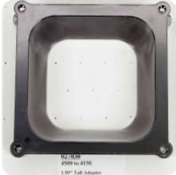

No there are no ports on this intake like some I have seen so I agree the spacer is probably my best bet. It technically is an adapter spacer to mount a dominator 4500 carb to a 4150 intake. It tapers down in the middle but still has a flat place on the outside that looks like it could be drilled.
1 drilled and tapped my 2" spacer for 10an fitting then put two 90 deg elbows in it and screwed a 1/2" electric ball valve in it. I can open and close it from inside the car.
