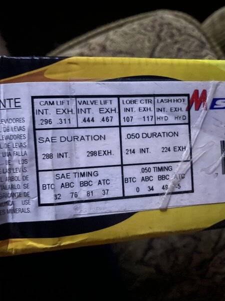

Hey guys, I’ve been trying to get my fresh built 440 RamCharger running right, and haven’t had much luck. I haven’t been able to spend much time with it lately, so I’m hoping someone here can point me in the right direction. I set the base timing at 16btdc, (haven’t checked total timing yet. I know I should). At first I bolted the carb on, and was able to break-in the engine. Whenever I try to accelerate at all, it falls on its face and pops out of the carb, sometimes stalling the engine.

RV cam (see pic for specs)

the advertised duration of that cam is way too big, for what you are trying to do. At idle your cylinder-pressure is gonna be really low. That engine is gonna want a lotta Idle-timing.

I don't like that cam one bit.

I didn't say a single word about whether that cam is; good, bad, or whatever. Nor did I suggest to replace it. All I said was;
and the reason I said that is because of exactly what it is doing in this particular combo, and what it will continue to do.
