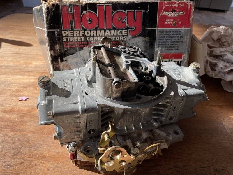

I’m wondering if this carb has some sort of problem. Because I bought it used from a member here (don’t remember who) and when I unboxed it, you could tell that it had been backfired through because of all the burns and “soot” in it.
I’m not blaming anyone but myself for these problems, because I’ve done all the work, and really have no experience with carburetors.
Maybe I should just stick with EFI haha
Interesting about the carburetor. I think I've seen @MOPAROFFICIAL talk badly about them, but I don't remember what, exactly. I tagged him, so maybe he'll chime in. I might be imagining things, but I seem to remember that.
Sounds like you need more pump shot.
What color pump cam and # shooter nozzle is on it and what transmission and stall is the car equipped with?
Thanks, dork. Been wonderin where you were. Hope yall are ok out there on the leftist coast.
That makes two of us so far.
That carb looks new enough that it should have backfire protection in it so it might not have blown the power valve.
