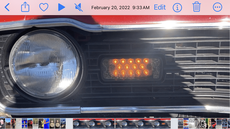

My Dart is all LED save for the headlights and those are GE Nighthawks on relays.

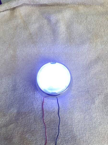

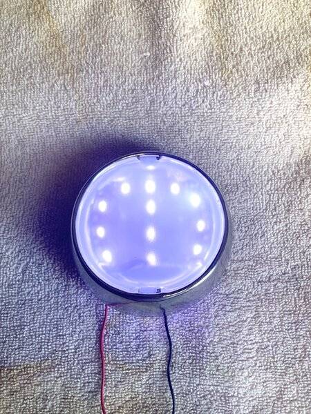

I’ve spent years testing and even building LED lighting for various uses and even my trunk interior light and license plate light are LED.
did my tail lights brake lights blinkers and side lights last year
LED Indicators/blinkers, side/running and tail/brake lights
