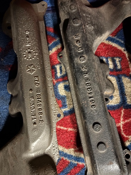

I have an early 1979 360 that now sits in a 1974 Dodge Dart Sport 360.
The manifolds I have are from a 318 car that is the ball/socket design.
I need the LEFT side that has the flat gasket style to match the factory style exhaust.
The numbers listed above are from the 1974 and 1973 parts books.
I really don't care about the numbers, I just need a manifold that will fit.
Please PM with what you have.
Thanks
Ray

71-74 340/360 a body are all the same for the left side.
That left side, 3614 395, has the ball and socket style flange. I need the flat flange that requires a flat exhaust gasket. I currently have that 3614 395, which is for a 318. I need to change to the 340/360 style, but even those have some slight differences. As long as it is the flat flange I should be able to make it work with the stock exhaust.

Thanks Yote, but the 2951916 (at least the pic I found on the web), is not the flat style that I need. Unless it looks different than this one.
Hmmm, I know it would not be exact, but I wonder if I could just machine down the "ball" section to make it perfectly flat, or at least flat enough to hold and seal the gasket. Just thinking out loud. It is late and weird ideas are starting to come out. LOL
You need a drivers side manifold shaped like the one in the bottom of the pic in post #1. All A body drivers side manifolds are shaped like that. The one in post #9 is a drivers side B or E body manifold, and won't fit an A body. They hit the steering column/shaft.
JD, I will defer to your knowledge and experience on the manifold that I need. You would think with all the A bodies out there it would not be that hard to find a left side with the flat flange. But unless I want to spend $700+ for a HP version (pretty rare I guess), there is little in the way of pieces out there. The hunt goes on, for now! :(

I have a 3614368-1 PM on the way
The true 72 and up 340/360 manifolds do pop up every now and then. The hard part is being in the right place at the right time to buy them. Hopefully, the one just mentioned above will be exactly what you need for the drivers side. A center dump for the passenger side from about any body style (A,B or E) will work in an A body. Hang in there....you'll find some!
