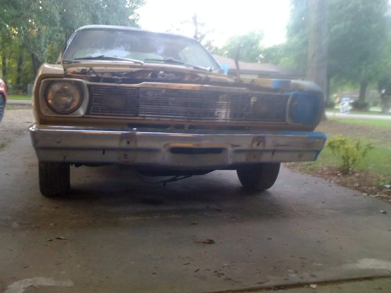

Here is a picture of the car as it sits right now. It still needs body work before of its ready to be painted. The head is a 83cc bowl and the cam is a 509 lift and 247 intake duration and 253 exhaust duration. Hopefully it will all make for a great combo.
Sounds like a great build and an enjoying one , keep us updated and enjoy this great site :thumrigh:
