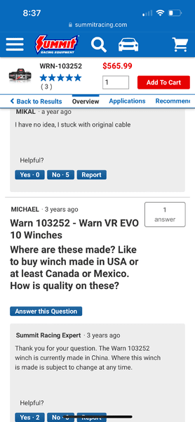

I don’t know about 17 years ago, but Warn is not being made in the US anymore. According to Summit, their 10k winch is being made in China
You can also read between the lines on the Warn industries webpage-
“For over 70 years, the small army of engineers, technicians, and machinists who design, engineer, and test our products are the very same people who use them, right here in the rugged Pacific Northwest.”
Notice it doesn’t say “build” or “manufacture” their products in that bit. That’s not an accident, it’s because they outsource their manufacturing now. They say they’ll “ship from our factory in Oregon”, but you don’t see “made in the USA” on their website. Because they aren’t.
Harbor Freight is a US headquartered company too, at least they’re not trying to fool you into thinking you’re buying US made products at US made prices.

The M series can no longer claim that it is “made in the USA”. They no longer meet the standard for that, which is why it’s not in the advertising anymore.
It is assembled in the US, but some of the parts are now globally manufactured.
Are Warn Winches Made in the USA?
And yeah, the VR EVO series is manufactured completely in China.

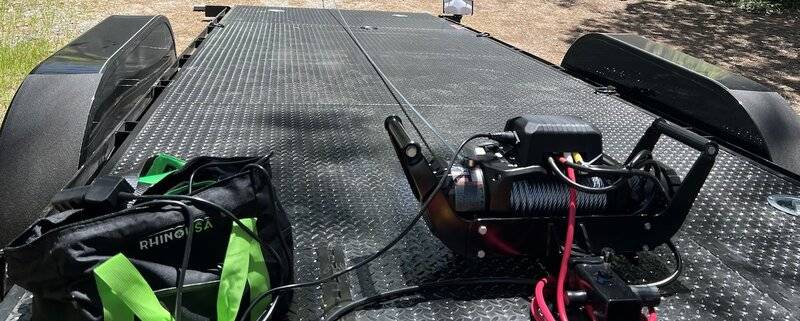

I bought a 9500 Badlands on their last sale and picked up the mount with handles. I was trying to get it to all fir in my tongue box but it was way too tight. I want to put my electronics in the box too. Planning on a Group 31 batt. fed by a 75W panel, small inverter w/ 110 plug and 12v acc. plug, 12v air pump, 12v transfer pump, Milwauke battery charger. I'm going to build recessed pockets in the center of the deck between the braces to fit ammo cans of chain and straps. All lockable. The idea is to use the trailer on different trucks and not have to have the winch wired through the trailer plug or rely on the quick connect jumper in the bed (5th wheel/gooseneck set-up). Another goal is to not have to keep anything inside the truck but I ran out of tongue box space.
This is the virgin trailer. Carson California Car Hauler. I’ve added the box but still need to cut it for the fair lead and build a plate and riser. I think a trailer build thread is coming, LOL.
