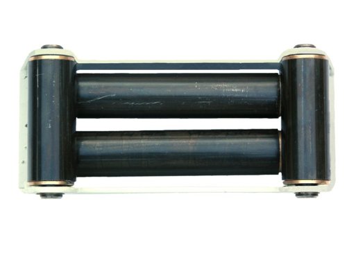

Pretty much have the same set up as most, I use a HF winch and snatch block, double line. The handy remote is a plus, its nice to able to steer the car while pulling at the same time. If I had to do the set up again, I would buy a nice trailer tongue box and set my winch in the box with adequate bracing for the box and winch. Using pinch rollers mounted in the trailer's headboard run the winch cable through the toolbox and rollers, clean set up. Out of the weather, lockable box and convenient, and be able to store all of gear and battery. If you have use a seven-pin trailer connector, you could use the feed wire to charge the winch battery as you drive.
