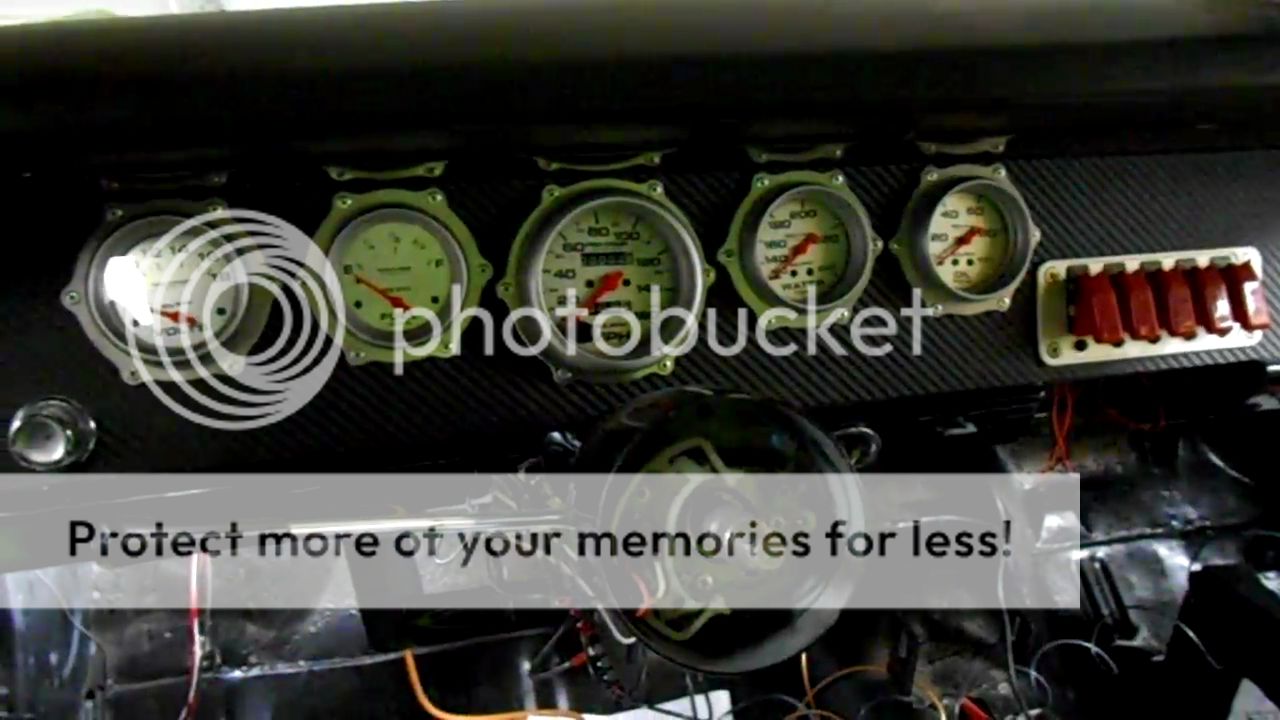

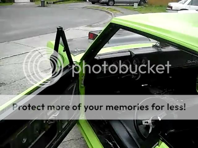

Just finnished building mine and the last picture is what the basic look of the dash will be when done.
This is one of the alternatives to running a dash pad.
The video is of the guages working on the test startup, but before the sensor was connected to the A/F guage.

It is .090 aluminum. For the gauge cups, I used roll cage tubing and had them cut at work in the machine shop. I used the tig welder at work to weld them on since my welder is only a mig and does not weld aluminum.
smartken22, yours is even better.
Did you use steel or aluminum.
What gauge ?
