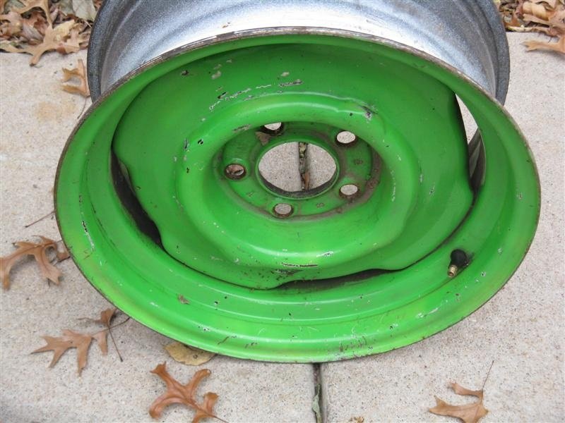

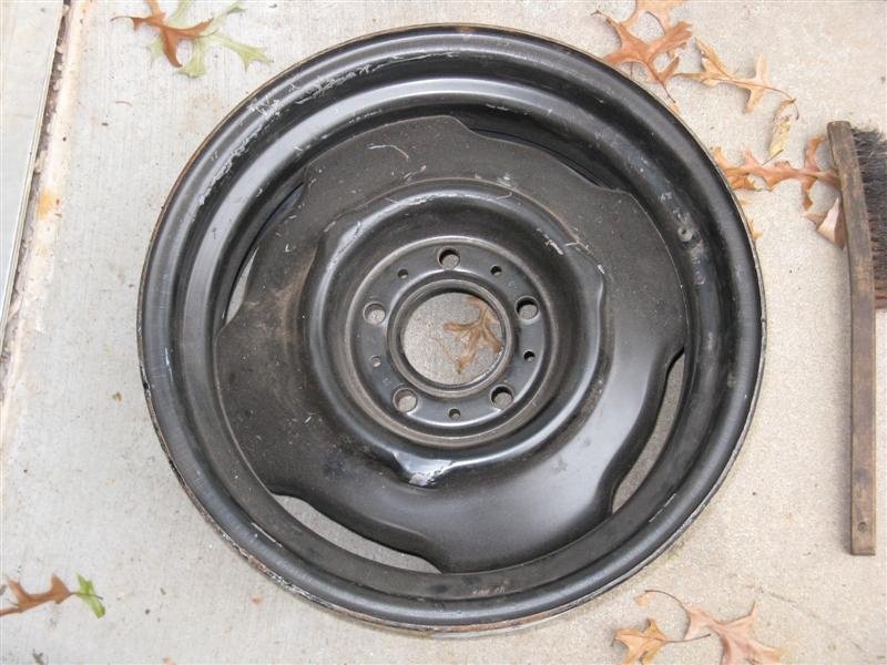

It looks to me as though there are two different styles of steelies. Most of them look round near the edge where the middle part meets the outer rim and some flatten out a bit. What is the cause of this difference?? Did they make the change in certain years???
Here is the difference I'm talking about: Pictures courtesy of member VDART.
attachment.php
attachment.php
attachment.php
attachment.php
Any ideas????
I think it depends on the 'duty' of the car, looks like the first rim has 4 nubs for the cap, and the different curvature tells me its more of a heavy duty design for a bigger car or truck possibly. The second looks like standard duty or possibly newer design like 1970+??
