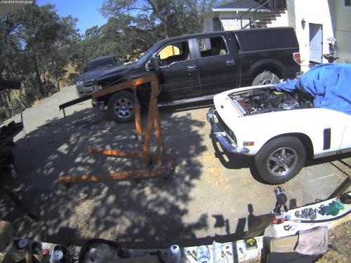

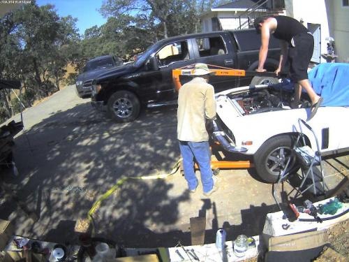

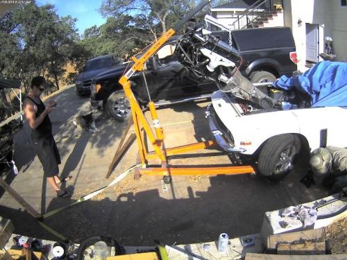

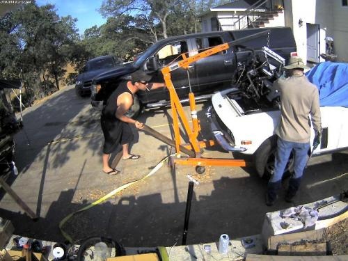

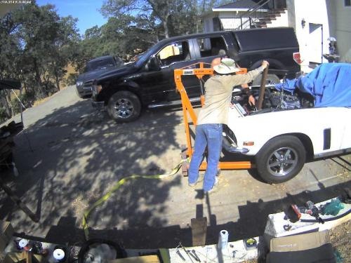

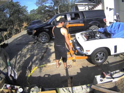

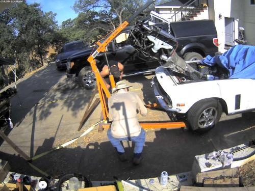

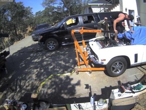

Well it is already done. If ya'll look at the pics I posted, you will see that it went in, albeit with a bit of massaging. No scratches or issues with the various painted parts b/c I used towels between the 2x4 pry bar and the related contact points. Seems that recent posting is like it has not been installed yet.
Also big thanks to Lee Robinson's son for suggesting that I do a bit of engine shifting with pry bars on the alignment dowels before trying to resort to more drastic measures! That worked properly after shifting the engine mounts about 1/4" in their saddles.
