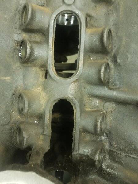

Captainkirk heres some cleaning up on a small block. It still needs to come apart for tanking, cleaning, and machining. You can see the cleaned up lifter valley return hole. Note pic 5. I did all of them the same way. Also clean up the casting parting lines to reduce stress risers. Use the same type of carbide burrs you would use for head porting. I would be leery about painting the lifter valley, and it peeling out and plugging your oil filter when running down the road.
Captainkirk heres some cleaning up on a small block. It still needs to come apart for tanking, cleaning, and machining. You can see the cleaned up lifter valley return hole. I did all of them the same way. Also clean up the casting parting lines to reduce stress risers. Use the same tyoe of carbide burrs you would use for head porting.

If your engine is a stocker it will never know if it's painted or not. Mopar's don't have issues with poor oil drain back unless you race it at high rpm. Just sayin'. Clean things up like @moparmat2000 showed above. That will do the trick.
Your engine will never know if it's painted or not. Mopar's don't have issues with poor oil drain back. Just sayin'. Clean things up like @moparmat2000 showed above. That will do the trick.
