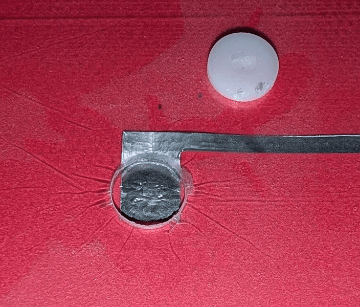

I was walking through a Meineke parking lot and saw a small broken piece of plastic. At work we were having a problem with getting our product laminated but still having a path to attach electrical wires. That little broken bit of plastic and my outside the box thinking came up with the solution...
Punch a hole into the upper layers of the lamination stack up
Insert a Teflon disk and laminate
Remove the Teflon disk and there you are, bare conductor to solder leads to. The disks were reusable too!
(This is the actual broken bit of plastic I found and my first attempt at the solution!)
