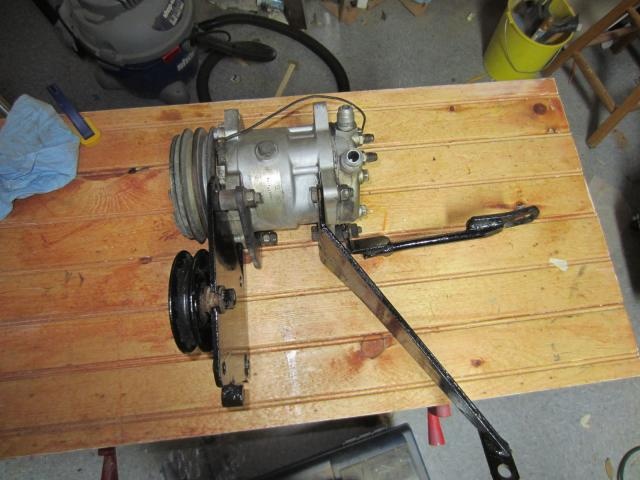

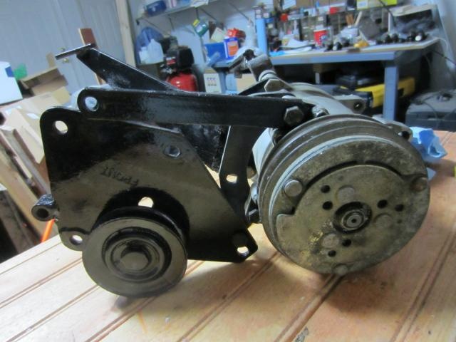

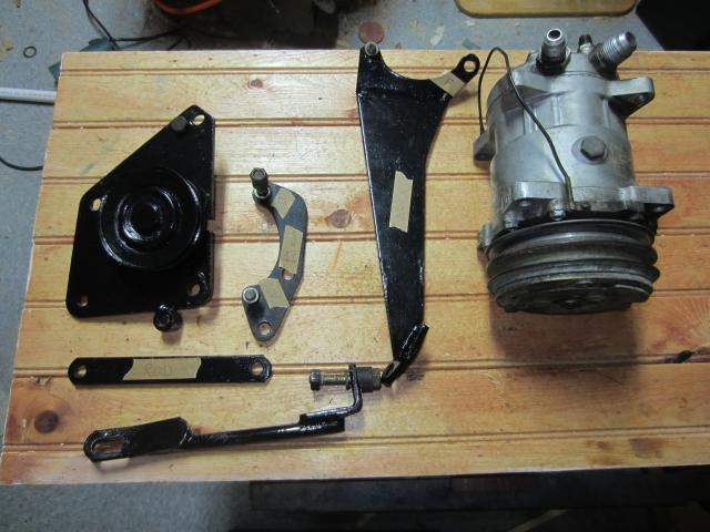

This came out of a 1963 Valiant /6 and I bet (hope) I saved my friend some time
on the plasma cutter and drill press I hope :shock:
Delivered to my door 71 danerors :hello2:
He said the compressor worked and was ran with one belt to the double water pump pulley using R 12 but I am thinking just the hardware was well worth the cost, what do you think ? :glasses7:
I am putting Vintage air in Victoria and I have herd horror stories on installing there systems on a /6 early A Bodies, so I went for it.

That looks handy to have around when doing your conversion Mike!! Nice find!! Geof

Nice find for sure! Looks like a time and money saver.

what ever you do dont run R12... if you can find it you probably dont want to have to charge it! for the cost 134 is the way to go, and yes i know it dosn't cool as well...
Defiantly going with a new compressor and 134 :thumblef: Yea that stuff is crazy high cost, but I think the new compressor will not use as much hp to run, I am not going to skimp on this update :thumblef: Thank you for the heads up
and making sure I am moving in the right direction :hello2:

thats a rotary (sanden) compressor so you'll see no difference in power loss between an R12 or R134 Sanden compressors. but a york you sure would!
oh, I see, the york is the old original old compressor that was used back in the day :thumblef: I can see clearly know :cheers: Thank you.
I wonder if I can save a bunch if this compressor is indeed good ? and even if it was ran on R 12 it should be fine to run 134 in it with all the new parts that .... NO never mind !
I think I should go new and un contaminated :thumblef:

R12 and R134 use a different oil that does not play well with the other, you would have to get all the old oil out for starters, i for some reason think pressures were different but yes, getting a new 134 compressor is best.
I totally agree, plus I want the new system to be all new and not have it send contaminant's threw out my new lines, dryer,evaperator and stuff so it will not mess up my warranty.. :thumblef:
