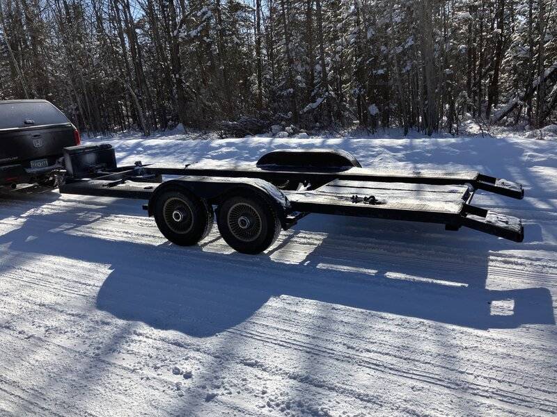

I'll try to keep this short. I'm looking for a used trailer/hauler, and I found this one:
Seller states right in the Listing: "...works great for cars...but fenders are a bit narrow for a full size pickup." But no dimensions were given in the Listing....
So I reached out to him, and he responded back with a dimension of 81" between the fenders (they're selling the house and have moved out, so he asked his neighbor to get this for me).
"That's great!", I'm thinking, as U-Haul trailers are 79" between the fenders, and I've used them quite a few times in the past.
So I drove out there this morning (a 1-1/2 hour trip), and his neighbor must be an absolute idiot, as here's the inside width dimension I get:
No idea where the neighbor got 81"...from anywhere or anything!
So here's the ask: Those of you with trailers, what is your "inside width dimension", and what do you haul with it?
I'm curious about this because I assume moving cars around would be ok, but I'd also like to move some 1/2 ton trucks every now and then, and this 75-3/4" dimension is "right there" on two of my trucks (depends on the tires), and I'm wondering what others here have on their trailers so I can decide whether to grab this one (if that dimension is a "standard"), or if I should hold-off and keep looking.
Thanks!
Jim

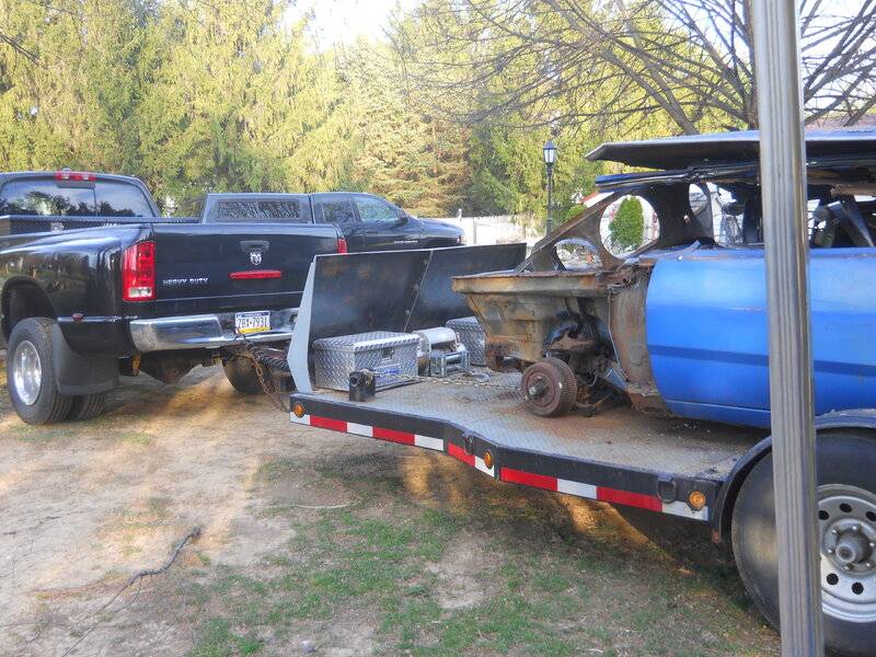

Dove tail and 6 foot slide out ramps. Deck the same width as the outside of the fenders front and rear so you can work on the car on the trailer. The trailer can also haul a dual wheel truck. Fenders lift off to open doors on low car. Fiberglass shield on front to protect what you are hauling. The trailer deck is 26 foot. We copied it from the red one next to it Just made the deck longer and wider.

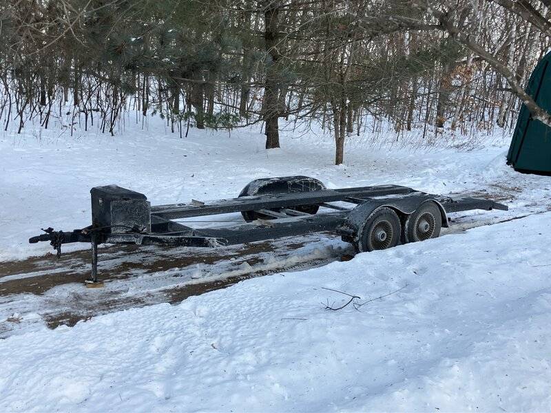

Done! 18’ trailer with dove and ramps, 83” wide deck, two 3500 pound Dexter axles, 225-15 tires, winch, tie downs, and good battery.
Sold, and draggin’ her home right now!
Thank you for all of the responses, gents! I think I got it right, thanks to FABO!
