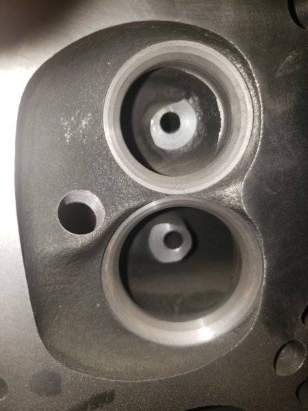

I have 1 cast iron speedmaster head that i confiscated from my machinist that were leaking from the deck face. It has 2 welsh plugs 1 at each end.
Has anyone flowed 1 to see what it is capable of?
Read the link ramm posted, he has flow numbers in the thread.

close up of valve seat on speedmaster cast iron head.
