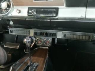

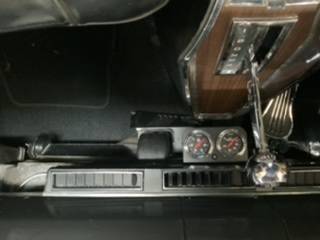

Here is mine. I turned the sender on the hose to the bottom so it doesn’t show so much. It is a mechanical temp gauge.
Would love to see a graph of that if you can get that from your efi.
No EFI on mine, all I can see is the gauge movement. When the car is warming up the factory gauge comes up slowly, the aftermarket one stays on zero. When the thermostat opens, the aftermarket one blasts up to 180 in a couple seconds. Depending on the temp outside, the aftermarket gauge seems to cycle from about 175 to 190. I don’t know how accurate it is, but seems reasonably close as I have a 180 t stat.
For some reason I have the picture upside down above…..
I like the simplicity of just have two gauges. Im debating as right now I have 4 possible. air/fuel, temp, oil, and voltage. Looking at yours I may have to rely on my gutted ammeter with volt gauge in it to do that job. Although the 'wizard', from the sniper has air/fuel, I dont want to have to refer to a little digital screen while driving. So, at least Id be down to three. I got pods for them to slightly angle them towards driver. We will see what happens.
Thanks for the pics, it really helps.
