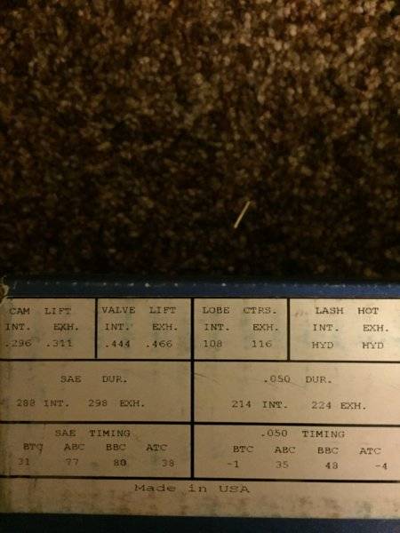

Here’s a picture of the cam card.
Cam is a 112 lobe separation.
108 intake centerline. I degreed it in 3 degrees advanced.

Also according to the cam card you show, your cam has 112 centerlines with 4 degrees of advance "ground in." Advancing another 3 degrees may have been too much of a good thing.

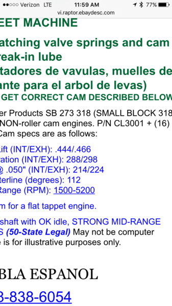

What cam is that? Looks like a good one for a Teen.
Doesn't look like a ton of duration at .050 but it gets with the program with the advertised total.

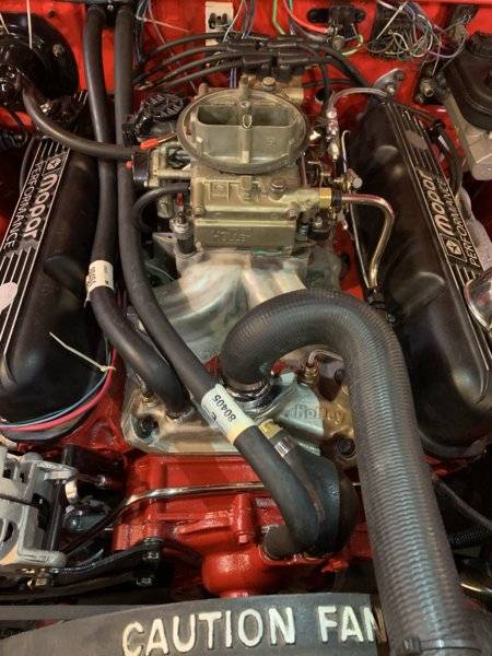

Where is the pcv valve plumbed for the vacuum source. The 390 4V carburetor does not have a proper port. I dumped mine after over a year of trying and tuning and installed an eddy Avs 2 now the car runs.
You can see it in the pic below on the passenger side of the carb.
