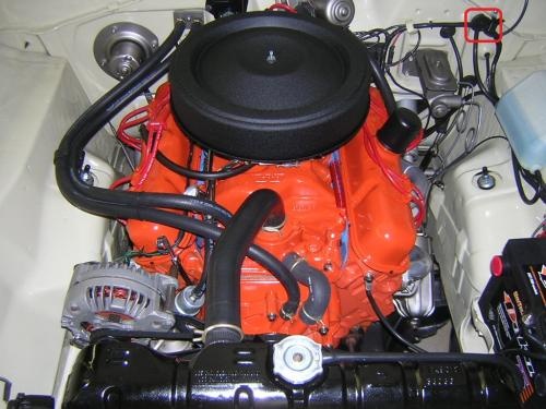

See the attached pic, upper right corner on firewall, outlined in red. If you have a rubber grommet there, its for the hose with a manual foot pump.

If the wiper knob will push in a bit, you have an electric washer wiper switch. Methinks you should have a foot pump since I don't see the washer motor wire that comes out of the harness running along the top of the inner fender. Looks to me like a PO replaced a frozen/broken remote mirror with an aftermarket one.
Thanks I'll have to check it probably is foot pump being a base model car. Where should this foot pump be? If that's missing I'll probably add the option for a wired pump.
