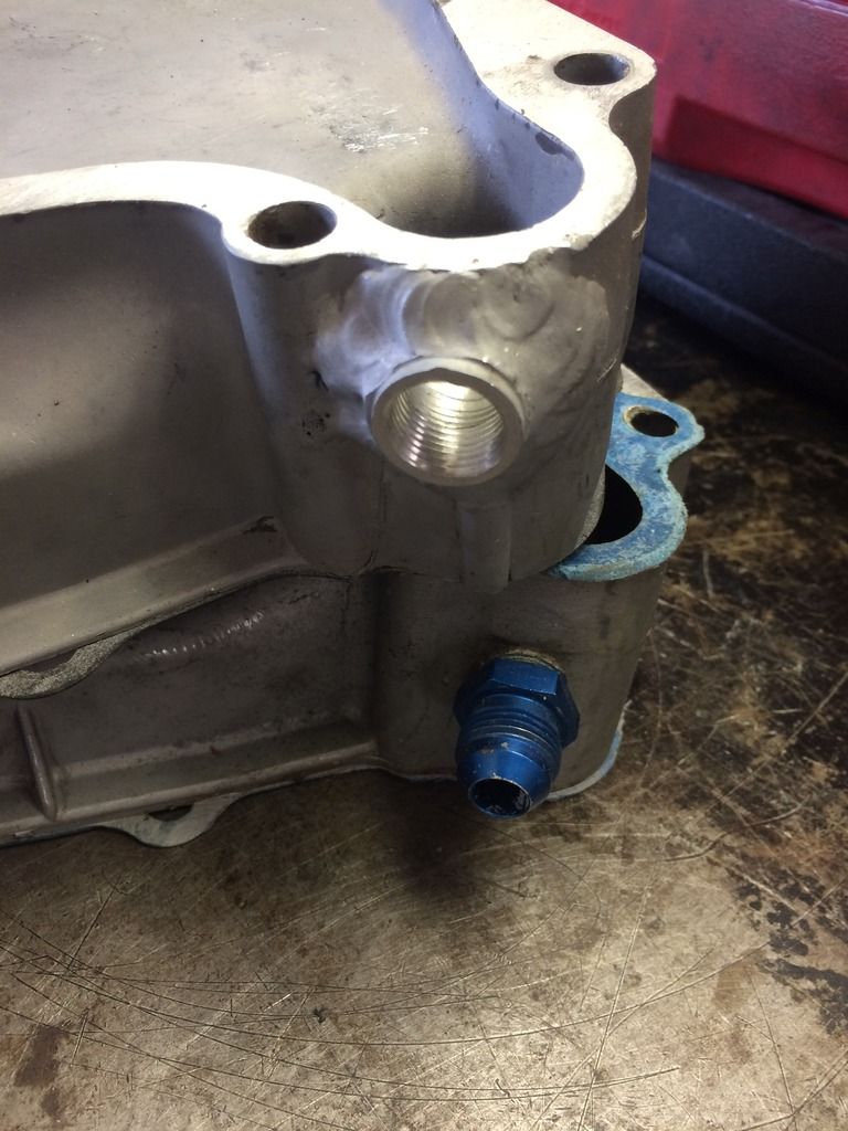

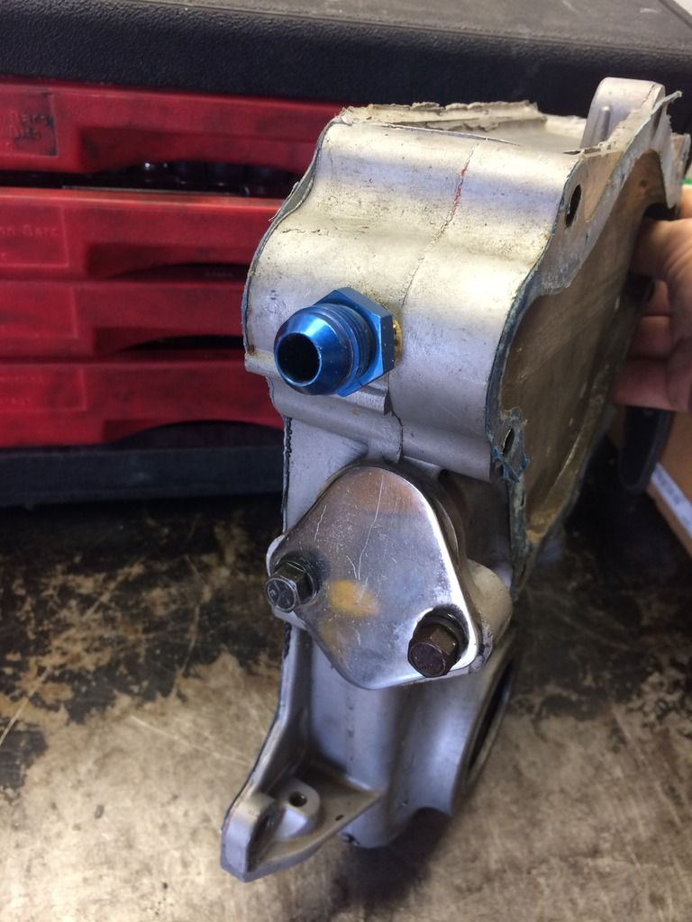

couple of covers I have from various projects on LA builds....
like I mentioned before, our W5 build we drilled and tapped holes into the block to run the lines to.
Hello a body. I was wondering if there was any particular reason that the fittings in you second pic are facing downwards versus the first pic that are at 90 degrees. Cosmetic or functional flow improvement.
