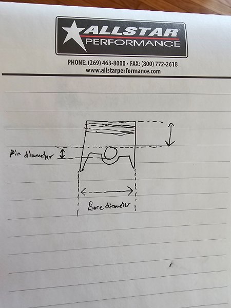

Are you adding 1/2 the pins diameter to your measurement?That is correct

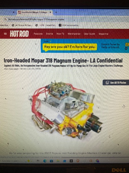

The attached article is not a stroker, but it will give you a good idea of what camshaft specs and valve diameter will really wake up a small bore build. It’s a very good read.
From the top of the pin to the top of the piston is 1.387Are you adding 1/2 the pins diameter to your measurement?

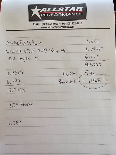

If you didn't add in 1/2 the pins diameter you have a setup for a stock stroke 318. with a 9.6 deck it will be .0295 in the hole.That is correct
What's the diameter of the wrist pin?That is correct
in your first post your measurement is 1.327". Where did that come from?From the top of the pin to the top of the piston is 1.387
1.327 is was without the pin inin your first post your measurement is 1.327". Where did that come from?

Add 360 crank or 4.000 Stroker crank what numbers would you have?Top of pin plus 1/2 of a chev pin diameter (.927") is, 1.327+ .4635 = 1.7905 for piston height. 1/2 (318 stroke is 1.655). 1.655 + 1.7905 + 6.125= 9.570 assuming no crank off-set going to the chev journal size, this puts the combo about 30 thou below unshaven stock deck height.

1.327 is what the neighbor had measured with the digital caliper and with the pin in I got 1.387 that is from the top of the pin to the top of the piston? You measure the inside of the top of the piston pin to the top of the piston if that is correct?This is based on your measurement from the first post 1.327. In post 29 you said 1.387. was that a mistyped?

I have bore measurement in all eight cylinders 3.97Are the pistons stamped as .060 over OR is the actually 3.910 + .060 measured? If your going by a piston stamped as .060 AND it's a chevy piston on a chevy con-rod combo, this is starting to smell like the chevy 283 piston @ 3.875 + .060 = 3.935 bore instead, which is only a .025 overbore. FYI the 283 piston is about 1.790 comp distance.
What are these these three measurments?1.327 is what the neighbor had measured with the digital caliper and with the pin in I got 1.387 that is from the top of the pin to the top of the piston? You measure the inside of the top of the piston pin to the top of the piston if that is correct?
