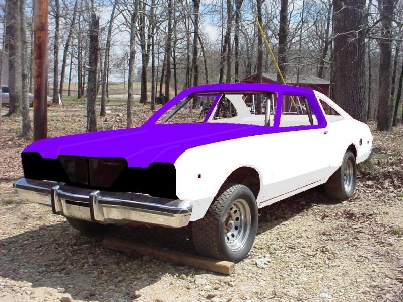

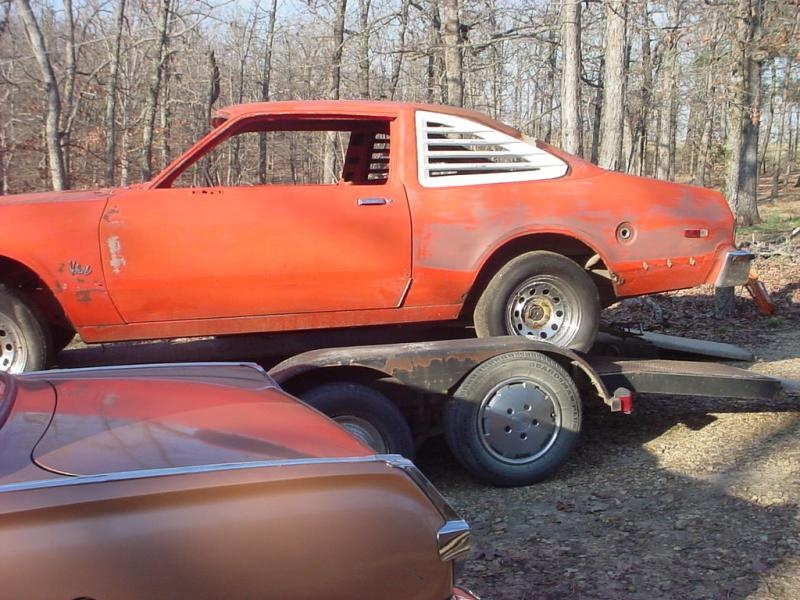

My son is building one out of a sponsored Valar'e these are the only picture I have as it is know in another shop and has the ford 9'' in and tran's and mid plate
It's been a VERY hot summer

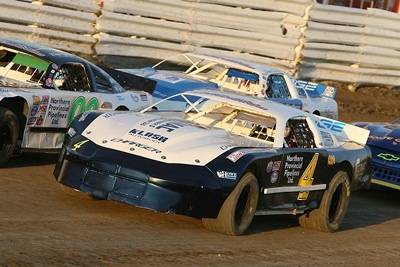

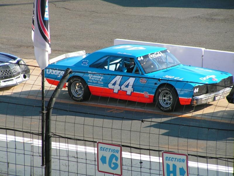

We have been doing it for years in an A body, its not really all that hard... We race asphalt on a very fast 1/2 tri-oval in N.C. (concordmotorsportpark.com) in the pure stock division. Currently leading the season points. (#44 Dodge) We race aganst mostly metric chevys, and handling is where we kill them.. I will be glad to answer any questions I can to help ya!

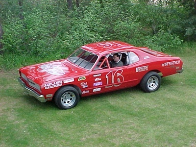

Moparchat is the place to check out. I built the first two cars shown in the pics. The first one was my favorite and won me the most trophies! I learned alot about a-bodies and circle track racing. If you have any specific questions, I can answer. Here is a pictorial history of my racing career!
Nice cars!! Love the the way the Dart Sport looks!
Thanks for the comment. I am racing the car in the last picture tonight! Its a pretty neat car 340 W2s 600+ hp, tex racing trans, 6.66:1 gears!
My choice would be to build an a-body for the dirt, but that because I have built one and raced it. If you go that route I can send you pics of the building process. Be prepared for alot of work and dedication to have a succesful dirt track car. Also make sure you have lots of good friends with understanding wives and girlfriends too!
