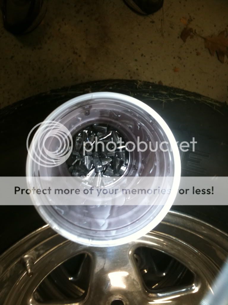

So, here's what happened after 5 passes on my new clutch Sure Grip.
I haven't pulled the hog head apart yet, but I believe these are most of the teeth off of the diff's side gears.
I let go of the brake off of the line, there was a loud bang, and then some grinding sounds. The trunk lid popped open! I was surprised/relieved to not find a puddle of fluid under the car when I hopped out. The car would actually still roll as long as I didn't give it any gas, but wouldn't climb the ramps on to the trailer.
I've got an 8" DOT tire and about 420 hp at the motor. This clutch unit went in to replace the cone posi that lasted in the same car for 50-75 passes last year.
I thought I had shredded the pinion gear until I got it apart. Of course, the ring and pinion is now junk from a couple of spots where the side gear teeth went through and messed it up. If I have it out again, I'm putting a drain bung in the bottom of my 8.75..

It was the clutch sure grip parts in the cup.
I put the clutch style unit in the last race of last year when I switched to 3.91 gears. It replaced the 4.11 cone type hog head I had been running the entire summer.
The 4.11 cone type is back in the car as of last night. Hopefully it will hold together until I can get something more permanent going.

So who is making the current clutch type sure grips? The originals were made by Spicer/DANA and were pretty tough. Looks like poor heat treat on the gears.
Did you make sure the case bolts were torqued correctly, and verify the clutch pre-load with a feeler gauge? I've seen Powr-Lok units in Jeeps fail in a similar manner, but it is usually because they were not set up right, or were really worn. Even then, the teeth smashed flat and didn't break off.

Not sure who makes the clutch type now. I'd be looking for an old original and going through it. There was something wrong if that one came apart at 420hp. I've run more than 550 through them before.
