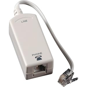

also... if it's DSL (i'm assuming this to be the case without seeing the modem models)
each regular phone attached to the phone lines MUST have a filter
the DSL modem must NOT have a filter
