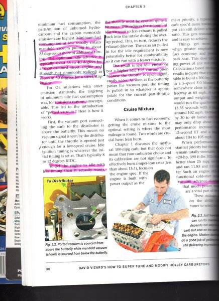

Plot your timing against rpm and like I said before, if you want MPGs you need ported vacuum advance to bring in another 10-15 degrees at your cruising vacuum.

The carb isn't right yet, may be the wrong carb 'not size' for the aspirations of decent mpg, but it still needs to be jetted down and driven hwy speeds..reducing the primary jet size until it surges, then go back up 2 jet sizes. Next dial in the secondary jets within 9 sizes of the primary, check vacuum and install pv at 3 to 4" below idle 'close enough for now' then the one of the biggest influencers... the distributor. It's a pro billet msd non vac advance 'which would help if it had one if mpg was a concern'.. it needs a sdvance bushing made to eyelid a mere 8 to 10 degrees so that he can have a higher initial timing.. like 24 degrees 'wherever the starter kicks it back warmed up, then back 2 degress'... and now the carb throttle position can be lowered.. may or may not be tickling the mains atm... and voila... it could get 12 or 15mpg.

10* initial timing is nowhere near enough with that combo. And if you are not using vac adv, that is only making it worse. Worse, because the engine is inefficient with it's current ign timing; inefficient, gobbles more fuel.
Your engine needs at least 30* of timing at idle [ not 10 ], & maybe as much as 40*.
Read these links & learn.
And.....
A smaller carb will not fix your problem & would be a bad move considering the whole combo. What you have is a tuning problem, not a carb size problem....
