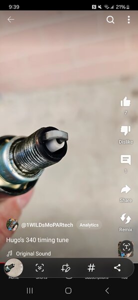

It got dark... so that's why we stopped with the tuning, for now. Going to drive it a little now and check plugs, check milage etc .
it pulls much harder, acceleration is smooth...and it has balls up top now it's not starving for fuel.
I like newbombs guesstimate of timing because that about as high as you would want it while still maintaining an advance curve. 8 to 10 advance is nice. His is all in by 2800 fwiw.
I normally will spend most of an afternoon test n tune with jetting and playing with pump shot.. but I got there a little later in the afternoon. It'll probably pick up 5 mpg immediately but expect it to get closer to 15 mpg. The higher initial means less fuel/pedal to get moving aka more power, less stink being cleaned up idle... not feeding from the mains... lowered throttle position. The timing shows a nice right before the bend initial and total burn mark.
It initially surged with the 65 jets, so immediately I went to 68's. Going to jet up depending on the plugs and feel... then he has a wide band he wants to get working..so that can aid his final jetting

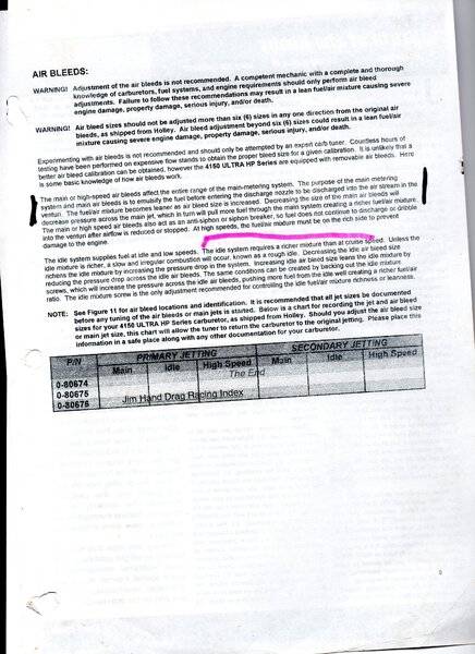

There you go......
Direct from Holley......
Since they make the carbs, maybe, maybe just maybe, they know how their carbs work.....
Air bleeds: 'DECREASNG the size of the main air bleeds....will pull MORE fuel creating a richer fuel/air mixture'. A smaller MAB also starts the system earlier [ lower rpm ]. And vice versa for increasing the MAB size.
There you go......

This is the same Holley that to this day is telling people to incorrectly tune their own carbs.
That paper is garbage. Like your tuning knowledge and skill.
Not testing what other people write makes them worship clowns like DV and believe error like this.
