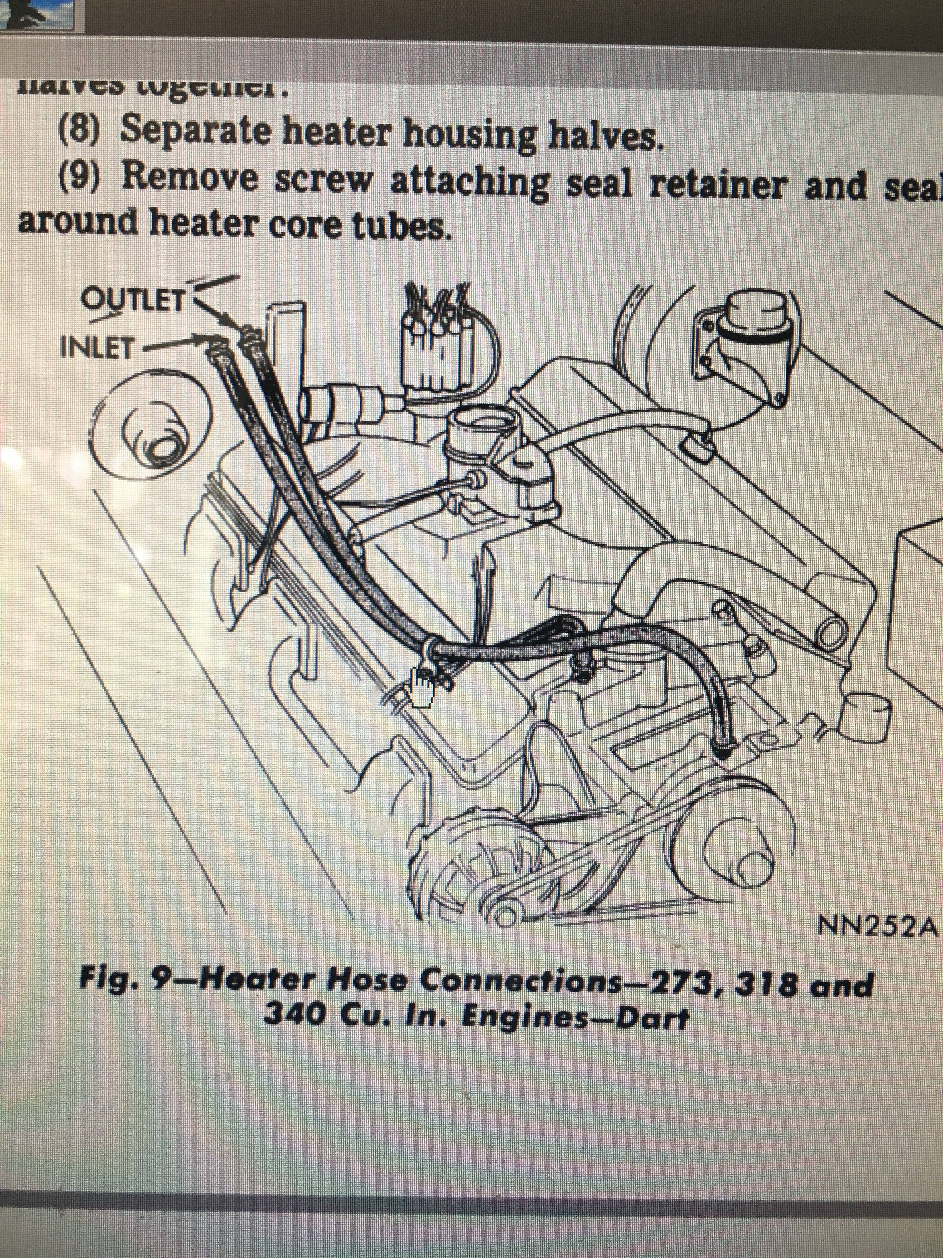

Good thought, I double checked and it appears that the heater has good flow and I've tested the heater valve to ensure that I had purged the core.
Heres apicture of the heater hose setup. Does it look correct?
Thanks!

Where is your 2nd temp sensor for the Stewart Warner gauge installed on the engine? The reading sounds pretty good if the stock gauge is midway.
FWIW, the heater hose connections are backwards at the firewall compared to a '65 Cuda....if that is the same as your later model.

Dang you all are right about the heater hoses. I double checked the manual and this is why I need a sanity check. See pic. I'll swap them to ensure the are correct. Can that really be the root cause??

No, the heater hoses will make (almost) zero difference in the cooling of then engine.
