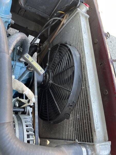

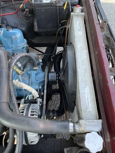

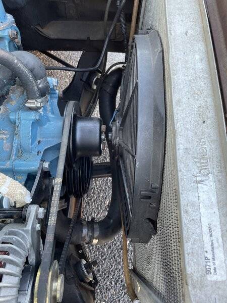

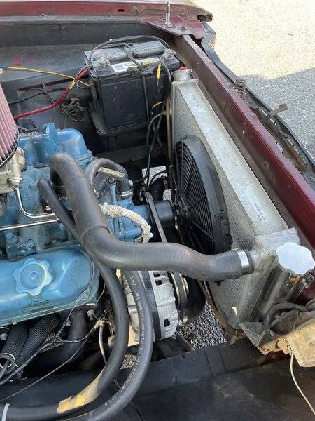

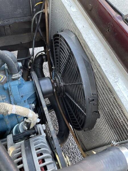

My car keeps over heating when I’m driving. It’s a 360 with mild cam. I have a Electric fan. It’s a low profile fan because it’s a small spot. Do I need a bigger fan? Or different radiator?
Which direction does the fan spin when it's running? To me, that looks like you may have a "pusher" fan mounted in a "puller" location... Either way, you should have a proper shroud on the radiator. Are you running straight water, or 50/50 anti-freeze mix? What temp is your thermostat? We need info...

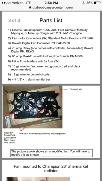

This is what I have its offset a bit. There is also a dual fan with shroud that some guys have used. Search Taurus Fan in heating and cooling thread. Did this problem just start. Is the fan a new install. Something like this may be better

View attachment 1715719945 This is what I have its offset a bit. There is also a dual fan with shroud that some guys have used. Search Taurus Fan in heating and cooling thread. Did this problem just start. Is the fan a new install. Something like this may be betterView attachment 1715719945
do you have a link to this fan?

It overheats when stop. It was cooling down when I was driving.
If it is overheating while stationary, that fan is likely the culprit. Ever if it was working really well, it on covers part of the radiator.
If it overheats at cruising speeds (40 mph or faster), it's usually a circulation issue or radiator issue. Usually a fan isn't even necessary when cruising over 40, unless you are pulling some long hills or overworking it. You need a clean block for good flow and a "sized per application" radiator that is flowing, and a water pump that's up to the task. Truth be told, you should be able to run a 160, or a 180, or even a 195 and not overheat at cruising speeds.
The factory temperature gauge is right dead in the middle when driving. When it’s stoped it goes pass the middle.
Ok, if it's only at idle then it's a good chance it's your fan and shroud set up. time to upgrade
Ok, that means the fan you have is not enough. No airflow when sitting static. Is that a 3 or 4 row radiator? You will have better cooling and more room for a real fan with a 2 row radiator with two 1.25" rows instead of 3 or 4 rows.
