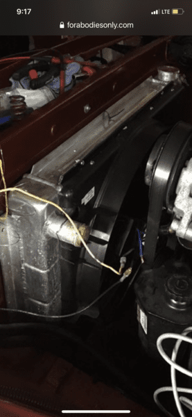

This is the space I have. Less than 3 1/2 from radiator to pulley.

Here’s what I got. Best pictures I could get. It’s really tight getting in there. It’s 4 1/2 thick from end of motor. The picture with the tape measuring from the inside of the engine compartment is to the center of the motor is 27 1/2. If I remember Abodybomber had the duel fans. I will have to look for his old post. God rest his soul.
