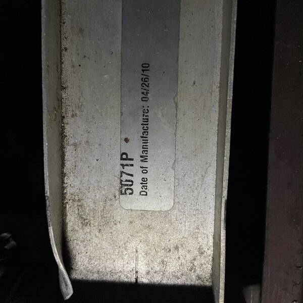

It’s a 5071p northern radiator from 2010. I don’t know too much about it.
You may or you may not. We have no idea what rad you are running. 2 row, 3 row, 4 row, what tube size?

Boiling when parked/after shutting off engine tells me it is in fact running borderline hot. and fan control isnt in live battery circuit. So heat soak pushes it over the boiling point.
Rad should cool, but fan looks inadequete.
