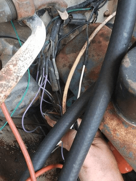

, I noticed that there extensions about 6 inches long spliced into most (but not all) of the wires heading to the distributor, coil, temp sensor, alternator area. I wonder if this is an original V-8 wiring harness put in to replace the factory /6 harness. The new one I am getting is a V-8 one, and I'll have to modify a few wires as needed.
If you post some pics we might be able to tell you.
Here's some new photos. The thick tan / off-white wire I am holding in one photo is the alternator output, it goes to the ammeter, then a red wire of the same thickness goes to the starter relay with a thin fusible link wired in at the relay end.
None of this is my engineering, except the 2 temporary wires (white and red) that go to the ECU from the distributor to get the engine running again.

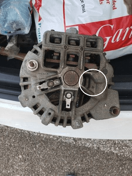

What size (amps) alternator is this? It has a dedicated ground terminal which was used and will continue to be used.
Back case looks like a revised squareback.
Where do you see a ground terminal???
There were optional alternators with slightly different wiring, but the regulator looks standard. (I didn['t check the part number.)
Engine Connector CE 37 deleted by a previous mechanic
The tan looks like a factory high amp alternator output wire.
It goes through a grommet?
That small silver nut and bolt at the bottom of the photo, has GRD cast into the housing and it is being used as a ground terminal to the radiator support, with other grounds also attached there. At least, that is how I got the car.

If the side view shows a thin stator frame, then that's a later revised squareback. I'm going to guess that there was some application that used an extra ground. Or, it is possible that an extra ground was added to the original alternator.
If the car came with a Chrysler built 60 amp alternator it would have the standard squareback case.
This is a '73 casting.
