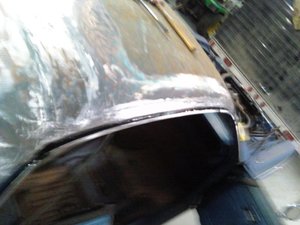

put the pennys to it as I can in a tuff year. i will try to post some pictures of progress as i go. DUSTER PASSENGER SIDE ROOF RAIL BEFORE 2.jpg

Pulled small rearend and added the 8.75 with3.91 sure grip.also adding coil overs. the engine is a 360 with lots of goodies!!! some more of the drip rail work.

So this is my start right now i have the dash back in waiting to wire up new carpet laid over new floor paint,new headliner seats reinstalled .Working on a tuff wheel setup transmission is to have a rebuild shift kit and 2100-2500 stall torque converter installed. i need to finish hooking the coilovers up hookup brake lines. then install motor.I welcome your comments keep in mind this is not a numbers matching car but it is very solid .will be a 360 punch 30 904 and 8.75 w/391 sg.i am trying to save up for som TTI headers the roof is in primer and i have to say that that was a big job with both sides rusted out .After I put the motor in I will start to re work the body. the color was a B5 blue but i am changing it to a surf blue which comes on the new challengers and they call it b5 blue but its not. I get a couple hrs a week and maybe 3hrs on the weekend to plug away at this I hope you enjoy my project. I have to say that this site has made this project must easyier to find parts for with good people thanks to all that have helped me.

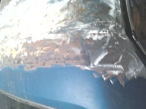

stripped hood was a little thicker then I had thought and i was lucky enough to find 35 year old bondo and red putty .so here we go.It will be a while before I can get back on it but will try to keep things going .I still have a lot of body panels to redue transmission to be rebuilt headers to buy,(ouch ).

Iwas able to get sometime today . I managed to strip the passenger side repair the plastic fix a small whole in quarter panel. So what is left to strip and prime is trunk and rear panel,drivers side. probably a couple more stripping and repairing days. All for now
