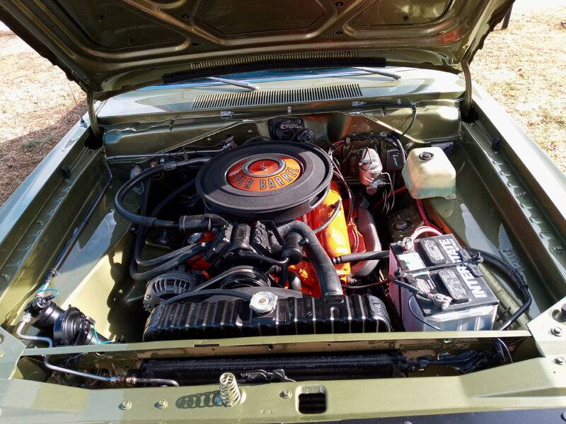

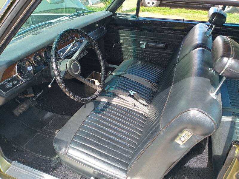

Here are some pictures of my 1970 Dart 340's engine compartment, the interior disassembled and assembled. I hope they help.
Thank you
Any chance you could take a photo showing where the bracket mounts?
Can you do another picture inside showing the vents? It's kinda fuzzy?
If you have a photo of the power steering area that would help as well.

Here are some more pictures. The FM converter is under the left strap that holds the vents. It looks the same as the right side strap.

Does the power steering bracket bolt to engine casting? The bolts leading to the timing chain cover? I see the front two piece bracket for the power steering utilizes the timing chain cover bolts through water pump?
The AC compressor bracket bolts using the top timing chain cover through the water pump bolts? Is there more one bracket used to attach the compressor?
I never knew about the AC vent straps. I don’t remember seeing them. I will probably have to go on the hunt for them.
Your bottom pulley has three grooves?

Or, may be like my '72. Some of the lines in my pictures are polution stuff that was starting. I can take more detailed pictures if you want. My power steering pump is a federal.
