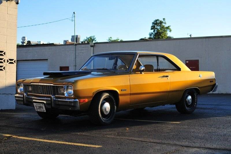

I disagree about the 74 being a "beaker". It's not. The 74 Darts are. The Valiant based cars stayed pretty flat across the front. I say look at them both. The 74 has a higher possibility of less rust and higher options, like big bolt pattern wheels, disc brakes and maybe an 8 1/4 rear end. Probably more accessories like power steering, power brakes and A/C. Things like bumpers can be changed if you so desire. The 74 may be more car bang for the buck.
Here's a 74 Scamp.
