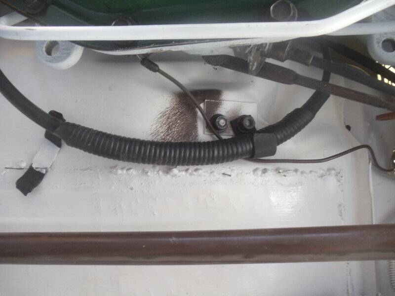

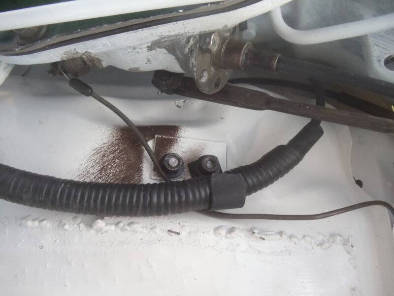

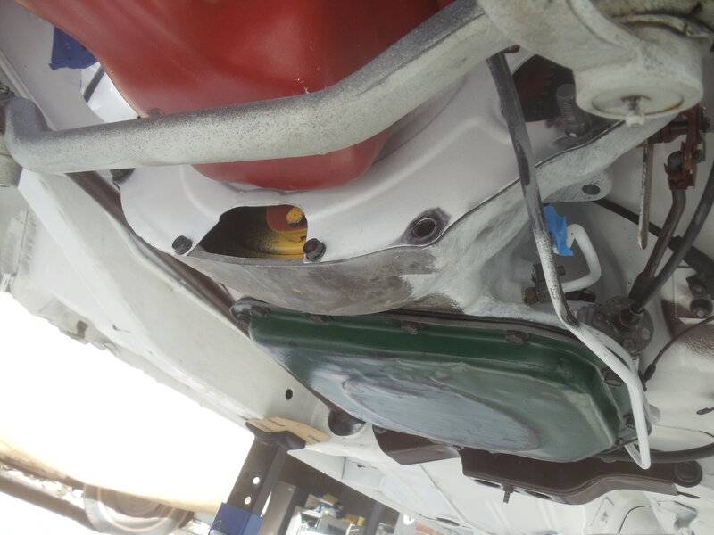

Are you using the factory clamps that hold cables (and speedometer cable) up against the floorboard? One for the parking brake cable goes on the nut/bolt that secure the accelerator pedal (photo #1). The other I believe has two parts (one for speedo/one for parking brake control cable) (photo #2). Or maybe model year '62 had a different arrangement? Photo #3 is an overview.

"Are you using the factory clamps that hold cables up against the floorboard?"
I can't use the factory clamps because I've got an LA engine and a 727 TF in a '62 Valiant, neither of which the car came with originally. But I am planning to drop the pushbutton mechanism from the dashboard in order to lube and adjust it, and to install a stronger overcenter spring, so when I do I will check out putting thermal heat sleeve on it rather than fiberglass tape. Thanks a lot, dibbons.
