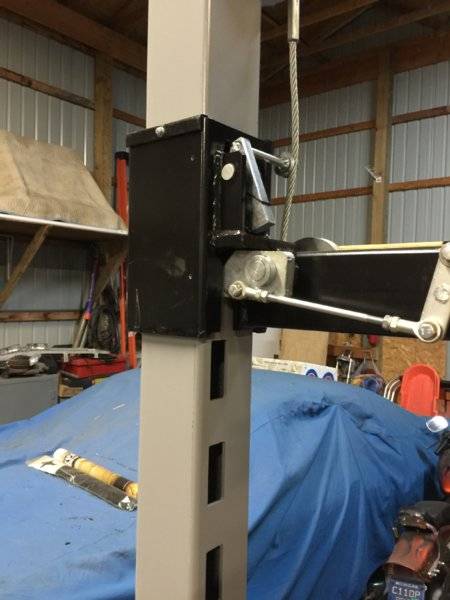

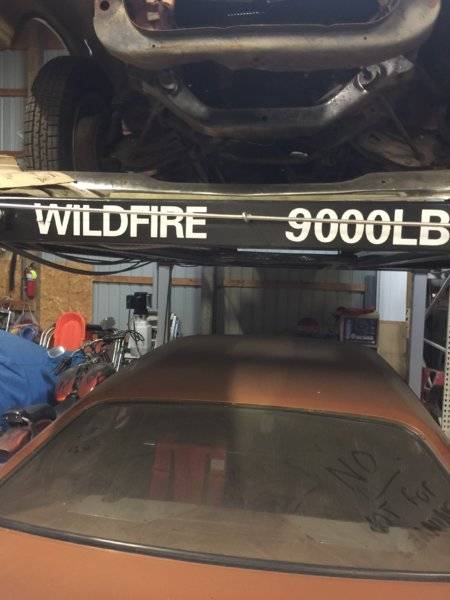

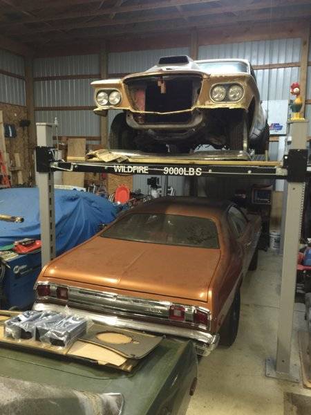

Wildfire lifts look them up ....and you don't have to bolt it down it has "skates" so it can be moved.

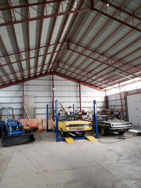

Well I own a Bend Pac like Jay Leno. He owns 30 plus of them. Mine is a drive on and I wish it was not. Pain in the but to do anything that requires the wheels off the ground.
