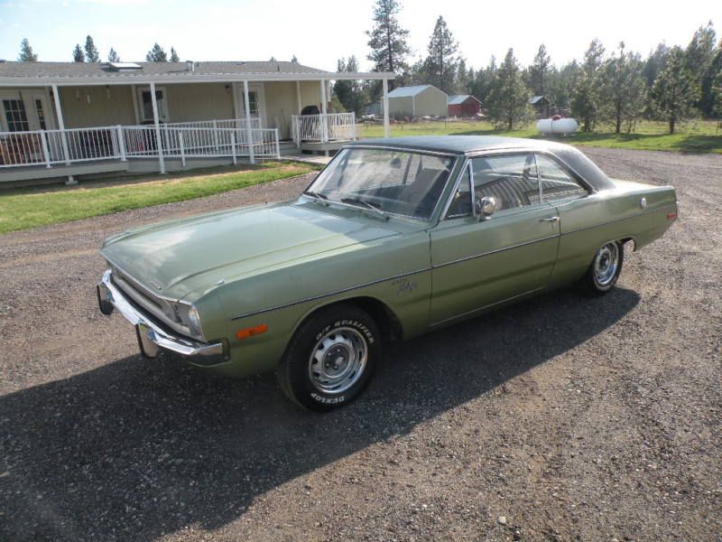

Hi Guys, well...............the deal fell through on the blue dart above. The guy sold the car out from under me. Not a happy experience. However, I did find this and the deal is sealed. It has a slant in it, but she's very clean ,all numbers matching, with all paperwork. I think this was a better choice for me anyway. That will give me time to save and buy parts to build a V8 for her. I appreciate all the help everyone is giving me. I am sure that I will count on you guys on the motor build. I am going to start searching for parts so I can get started. As I mentioned before earlier, the link to the motor I posted is what my car to sound like. Everyone has given me great advise. I got to start with a block first. Not for sure what tranny and rear are in this car yet. It is a 72. I won't know till the truck gets here with it. Such a great forum. Thanks to everyone again for all the help.

Think you might've gotten a better deal with this one! Looks good to me-looking forward to seeing any changes you may have for it! You'll have some info for us in the restoration section, right?
That I really clean, how many miles?
What did you have to give for it if you dont mind me asking.
Yea, I'll be tossing her in there. Be looking for alot of motor help.
I am not for sure on the miles exactly. Do I have to realllly have to give the price? Lets just say I have searched for six months for cars in the 3-4k range and have looked at about 1000 cars, and now I have one coming. Alot of work and alot of hit and misses.
