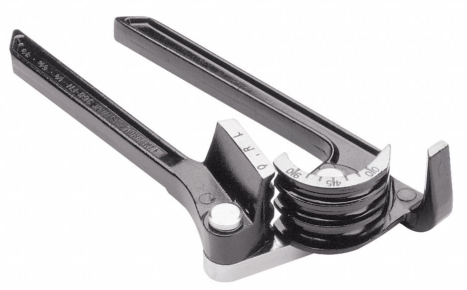

What are you using for a bender? If it's not an all metal name brand traditional bender like Imperial, etc, you are wasting your time.

These types here.......come in various forms, more or less expensive, more or less "strong" some are single size and some stepped like this one
Don't beat yourself up. I would not be adverse to ordering a repop 3/8 tube, and there is stainless braided teflon options as well. I WOULD NOT RUN rubber unless it has a stainless inner braid
