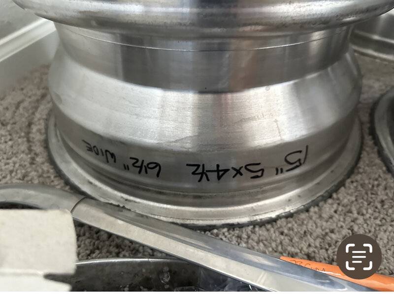

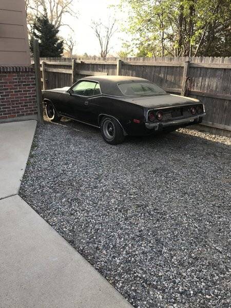

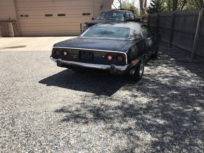

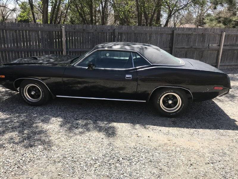

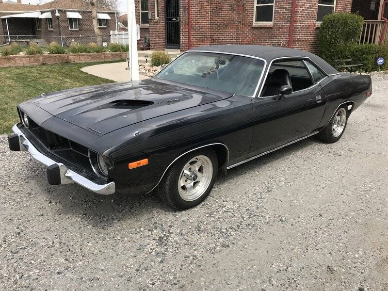

My son had a 1974 duster project car that he was forced to abandon. A few months later he bought a 1973 (360) four speed Cuda. He picked up four American wheels for it (sizes in pictures) 6.5 inches for front and 8 inch for back. I’ve been out of the Street scene for to long to recommend tire sized and makes. I recommend he sign up on Ebodiesonly but wanted to pick you guys mind. He doesn’t want a race type radial but does want some hook for the modified engine. Here’s a picture of the wheels and car.

Looks like my car used to. 275 wide is an easy fit in the back. 255/60 fits nice in the front. Wider can be made to fit the rear but you need to move the springs and have the right offset.
275/60-15's for the rear and 235/60-15's for the front. That's what I run on the last few E bodies I've had and they clear well. I do have 245/60-15's on the front of my Challenger conv, but they will rub the frame rail if turned to lock. The only time I've EVER had the 275's rub on the back was when 2 fat girls wanted to ride in it at a car show. I tried to wriggle out of it by pretending the car wouldn't start, but my wife said (with an evil grin on her face) "Honey, did you cut the kill switch off?" :BangHead:
Love the daisies. But if they are the original one piece, they might not have enough backspace to run real big tires.
I would probably run nitto 555 G2 on the front, and nitto 555 RII on the back. They are "drag radials" but not near as soft as a Hoosier or M/T, and should wear better. If the daisies are one piece, 225/60x15s for the front, 275/60x15s for the back.... if they'll fit.(255 for rear might be a better choice, if nitto makes that size in the RII.
